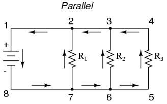

    Okay so this diagram ......
    [​IMG]
    ....is equal to this diagram....
    [​IMG]
    Minus R3 (the third branch) of course...
    Would that mean that if I touch the broken hot wire toaster while it is toasting a slice of bread and I get shocked by creating an unintended parallel circuit through earth, in theory, I will not affect the current flowing into the toaster (therefore, not affecting the operation of the toaster's bread toasting ability); I will only be adding total current before outside of the branch paths. This this correct?
    Also, would that mean if I were to touch the broken hot wire toaster while toasting a slice of bread and at the same time another person touched the toaster and got shocked, the added current running through his body would not affect the amount of current running through my body, since he would be just another parallel path added to the circuit. This would also mean that the current running through both our bodies would not have any affect on the current running through the toaster for the same reasons already mentioned.
    Is this all correct so far?

    Yes and Yes

    It is flawed to say
    Whilst this is certainly true, it is incomplete. Worse it is could be taken to mean that electricity does not take any other path, which is not true.
    It is not much better to say that most of the electricity takes the path of least resistance, as this does not tell you how much is most.
    A good working statement is
    Electricity takes all paths available to it, in inverse proportion to the resistance of that path.
    this is what other meant by parallel paths etc.
