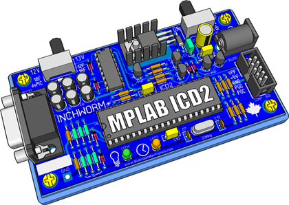

PS want a good project for a 16F877A, try building a decent programmer with it.
My ICD2 clone the Inchworm would be ideal IMHO.

An ICD2 even though it's old and barely supported by Microchip anymore, is still a far better programmer then the K150. It's a little slow but it's also a debugger and can program many many PICs including the 18F2550 for when you build your first PICkit2 clone. See my Junebug PICkit2 trainer for details.
The Inchworm is very easy to build, common parts include a MAX232 or ST232 plus the .hex file is easy to find and should still be on Microchips site. MPLAB 8.xx still supports it.
