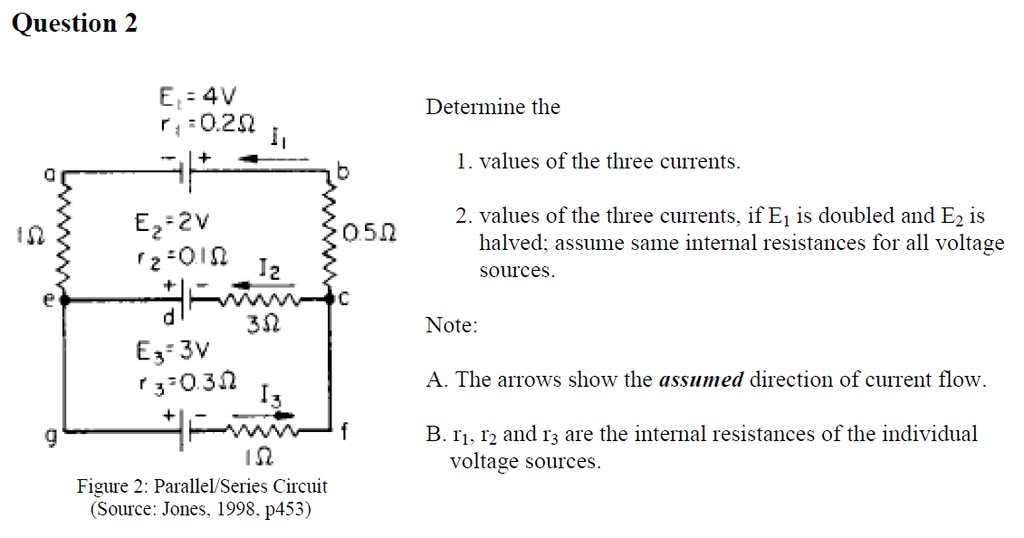

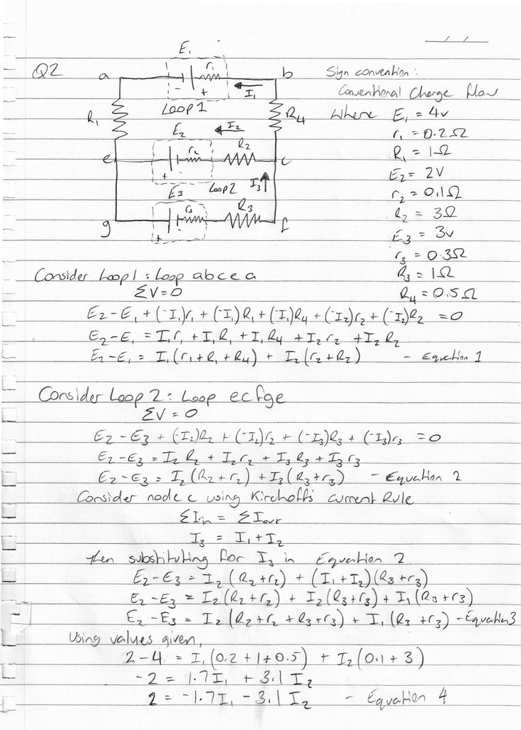

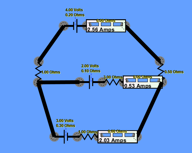

    I am really stuck on a question for my first year engineering physics course involving a circuit with 2 loops and 3 voltage sources. I have tried 6 times and gotten 6 wrong answers! Can anybody offer me any advice for where I am going wrong?
    Here is the question, my latest attempt, and the circuit in PHeT simulator

  2. adam555
    Active Member
    Aug 17, 2013
    858
    39
    In your first equation of loop 1 E2 should be added to E1, not subtracted.

  4. adam555
    Active Member
    Aug 17, 2013
    858
    39
    You got most signs in the first equation wrong (I guess in all equations).... you need to imagine a direction of the current (either clockwise or counterclockwise) on each loop and then go through each element looking on whether the sign of the voltage is in the direction of the current, or against it. If the the element has a negative to positive in the direction of the current, then it's a positive element on the equation; if not, then it's a negative; like this...
    E2 + E1 + (I1*R4) - (I2*R2) + (I1*R1) = 0

    So from the assumed direction of the currents given the current would flow anticlockwise in both loops. So that gives E1 + E2 in Loop 1 as you say, and which I have changed it to, and E2 - E3 in the second loop, which is what I have. Since voltage always drops over a resistor shouldn't all of the values be (-Ix)Rx..?

    Sorry, like this....

    You go element by element in a direction and check if the current goes in one or another direction; you had the E1 and E2 right, it's I2*R2 you got wrong.
