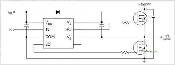

    Those gate drivers won't have the same issue as the current ones I am using?? (http://www.avagotech.com/docs/AV02-1843EN
    Is this what you are proposing?
    [​IMG]

    The IR2111 is a readymade mosfet halfbridge driver with the necessary deadtime ciruitru already built in, all you need to do is to supply your PWM signal and you will get a 0-300V output.
    Using separate drivers like you are, you will need more circuitry to generate some deadtime to avoid shoot through/cross conduction in your mosfets which will cause EMI to be radiated as well as heating of the mosfets.

    I see what you are saying... this is the circuit I see with the datasheet. This diagram can do exactly what I want I think?
    [​IMG]
