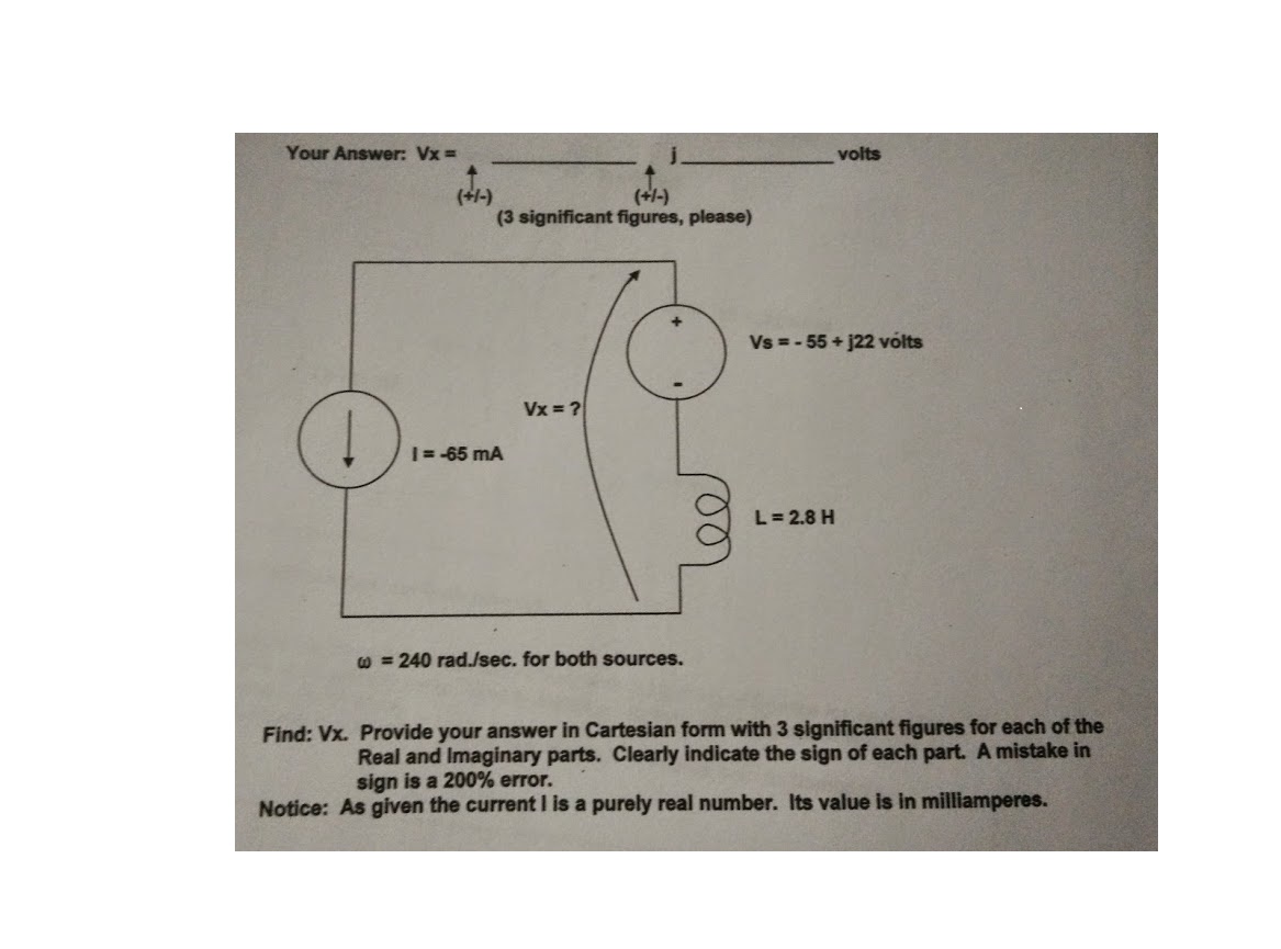

I started by finding
ZL = jwL which gives j(672 Ohms)
Don't know where to go from here.
TIA
Would it beThen you find voltage across your 672j Ohm "resistor".
Yes.Would it be
VL = IL
=( - 65 x 10^-3 A) (672j)
= -j 43.68V
Would it not just be :Yes.
But. Now you need to watch out your polarity.
VX=VS+VL That is correct. But if your polarity is wrong, you will use VL with wrong sign and get wrong answer.
Replace the inductor with a voltage source. Place the polarity symbols into the voltage source. Now you have two voltage soruces in series. Do you know how to "add" two voltage sources in series?Would it not just be :
Vx = (-55 + j22 V) + ( 0 - j 43.68 V)
= -55 - 21.7j V
I think i figured out where the mistake I madeReplace the inductor with a voltage source. Place the polarity symbols into the voltage source. Now you have two voltage soruces in series. Do you know how to "add" two voltage sources in series?
The current enters the "resistor" from the bottom and moves up. The terminal where current enters is assumed to be positive. The terminal where current exits the "resistor" is assumed to be negative. The current flows from higher voltage potential to lower voltage potentia.Isn't adding voltage sources the same as adding resistors in series? Req = R1 + R2 +...+ Rn
Thanks a lot for the help!The current enters the "resistor" from the bottom and moves up. The terminal where current enters is assumed to be positive. The terminal where current exits the "resistor" is assumed to be negative. The current flows from higher voltage potential to lower voltage potentia.
So the bottom terminal is positive, upper terminal is negative. But the voltage across the "resistor" is -43.68j volts. What does that mean? It means that our earlier assumptions about which terminal is at higher electrical potential (positive) were wrong. So we will do a simple thing. We will make upper terminal of the "resistor" positive, bottom terminal will be negative, and now instead of -43.68j volts we have +43.68j volts.
Also now we have two voltages connected from positive pole to negative pole, now we really can add two series voltages: Vx=-55+22j+43.68j
