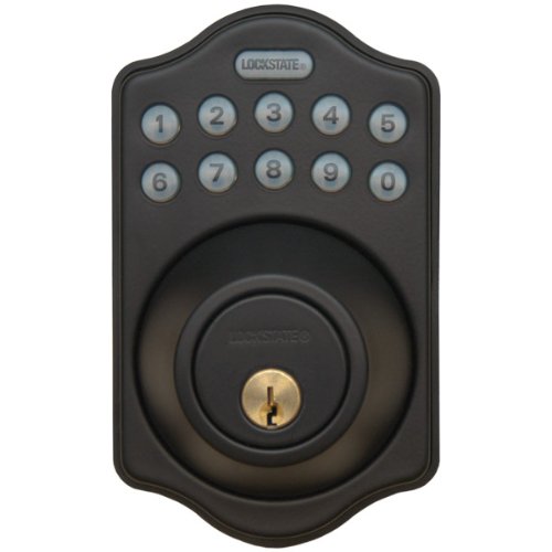

    Hey all i have a project i am interested in doing. It involves an Arduino and a Kwikset 909 Smartcode Electronic Deadbolt. I am looking to program the Arduino to mimic me pushing the keypad on the deadbolt face so that it will unlock using my cell phone, webpage, etc etc since the Arduino will be hooked up using the Ethernet Shield to a web server at the house.
    The image of the deadbolt unit is this:
    [​IMG]
    Problem being is that i do not know how to go about using the arduino to "push" the buttons since they seem to have 2 digits per button. Also, how would i go about wiring them up so that i only have to use one ground wire for each button so it minimizes the wiring i'll have to use?
    Is this possible? What would the wires to each button need to be? Positive or negative to trigger the button?
  2. bertus
    Administrator
    Apr 5, 2008
    15,645
    2,344
    Hello,
    Can the keys wiggle?
    So when you press left, the left number is used,
    and when you press right, the right number is used.
    Bertus

  4. BSomer
    Member
    Dec 28, 2011
    433
    106
    After a quick browse through the installation/programming guide, I don't think that the keypad is actually a 10 digit keypad. The porgramming guide says you only have to press the button once to get either number.
  5. crutschow
    Expert
    Mar 14, 2008
    12,991
    3,227
    It would appear there are only 5 push-buttons with two numbers on each button. I had a car with a door-lock that worked the same way. Having two numbers allows you to select a number sequence that's easier to remember.
    You'd have to look at the circuit, but I suspect that the buttons have a common return connection which would mean seven connections from the keypad.
    I would think you can likely activate a button by turning on a CMOS mux switch, such as the CD4051, from each button connection to the common.
  6. Dodgydave
    Distinguished Member
    Jun 22, 2012
    4,969
    744
    I bet the keypad uses key scanning , in which case it will only have 5 wires, in a matrix formation.

    What i plan to do with it is this:
    Create an Android App that runs in the background and after 5pm it checks every 3 minutes the GPS lat & long of my position and when I'm around the house it will send a command to the server and it will unlock the door before i get to it from my driveway.
    I just wanted to make sure i would be able to mod the deadbolt first since i have not seen any Google listing s for the model i will be purchasing.
  10. Dodgydave
    Jun 22, 2012
    4,969
    744
    Well if that's the what your after, then you just need to switch a relay to power the motorised bolt, or maybe use the transistor/relay output in the lock, so you wont need to connect to the keypad?

  12. Dodgydave
    Jun 22, 2012
    4,969
    744
    looks like it, does the motor reverse when you swap the wires round?

  14. StealthRT
    Thread Starter Active Member
    Mar 20, 2009
    223
    0
    Well I applied 5v to those 2 pins and whatcha know it... yeah you guessed it.
  15. StealthRT
    Mar 20, 2009
    223
    0
    Hum well i went ahead and bought this one for now (LockState LS-DB500R-RB [​IMG]). I will be ordering another replacement again sometime soon and will update this post when i have! :)
