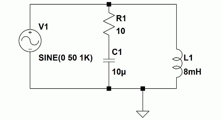

    In the first question proceed as follows
    1. Draw the circuit - at least to give an understanding of the layout.
    2. Convert the capcitor and inductor values to their equivalent reactance values Xc & Xl at 1KHz
    3. Convert the two series branches to an equivalent lumped impedance
    4. The capacitive branch will have the form Zc=Rc-jXc and the inductive branch Zl=Rl + jXl
    5. Calculate the current in each parallel branch
    6. Use Ic = (50@angle 0)/Zc and Il=(50@angle 0)/Zl
    7. Add Ic+Il (using complex notation) to find the source current Is.
    8. Is will have required phase angle, Theta
    9. Power Factor = cos(Theta)

    1. Draw the Schematic.
    [​IMG]
    θ=arctan(XC/R)*-1 for the first branch.
    θ=arctan(XL/R) is the same for the second branch.
    And that's where it all drops off for me. Which means, I need to study again! It does wear off. I hope I die before I seriously forget.

    Hi Coffe Guy,
    Vanilla, Caramel or Hazelnut?
    You missed the 15Ω loss resistance in the inductor.
