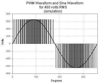

  17. strantor
    AAC Fanatic!
    Oct 3, 2010
    4,302
    1,989
    The term "inverter" is broad. It can refer to a VFD (AKA VSD, ASD, drive, et. al.) which is a dedicated inverter for a motor which is what I was talking about, or it can refer to the appliance/utility type that you're talking about. Indeed, some devices do need a pure sine wave and thus need one of these "pure sine wave inverters." Motors are not one of these devices. Motors will accept quite a nasty input and not fuss much about it.
    An inverter, or what we should refer to as a VFD from now on, does not feed a "square wave" per se, to the motor. It feeds a bipolar PWM "sine" wave to the motor. It's a bunch of nasty chopped up DC, pulsed at several KHz, that the motor interprets as an ordinary line frequency. The inductance of the motor's coils "average out" the PWM pulses, so an oscope reading of the voltage across the motor's terminals would look ghastly, but a simultaneuos oscope reading of the current through those same coils would reveal a pretty sine wave. see the illustrations below:
    [​IMG]
    [​IMG]
    and this real life picture of the comparison of PWM voltage Vs. coil current as measured on an oscope:
    [​IMG]
    These VFDs only get away with this because of the motor's inductance. Your xantrex or whatever needs a pure sine wave output because the laptop charger that you plug into it has no high inductance coils to sort out the nastiness.
    Now, you were onto something though with the "square wave" bit. All this switching in the KHz range causes voltage spikes that are higher than what a motor would ordinarily experience if connected directly to line voltage. This can cause the insulation in the motor to break down prematurely. For this reason, "Inverter Duty" motors are sold, with better insulation and better cooling (for running <full speed).

  19. timescope
    Member
    Dec 14, 2011
    298
    44
    strantor,
    Thanks for the nice pics. They also illustrate how pure sine wave inverters work as they also use pwm techniques. The output transformer removes most of the harmonics.
