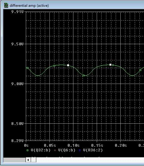

So, I took hgmjr's adviced and replaced the current mirror with a four-transistor Wilson current mirror.
The updated circuit:
http://i51.tinypic.com/20zuqgm.jpg
Right now, my primary concern is that the output immediately at the differential amplifier is centered too high.
I don't need the differential amplifier output to be centered on 0V, but I do need enough for it to produce a clean waveform: since the highest practical input I'm going to encounter is 0.01V and the gain of the diff. amp stage is about 50, I need about 1V peak-to-peak worth of breathing room. In this case, this means that the diff. amp output needs to be centered at about 8.7-8.8V. As is, it's centered at about 9.2V and it's causing outputs like this (input=0.001V):
Needless to say, when this is amplified again the waveform doesn't come out right.
What are my options in terms of shifting the differential output downwards, or am I just up the creek on this one?
