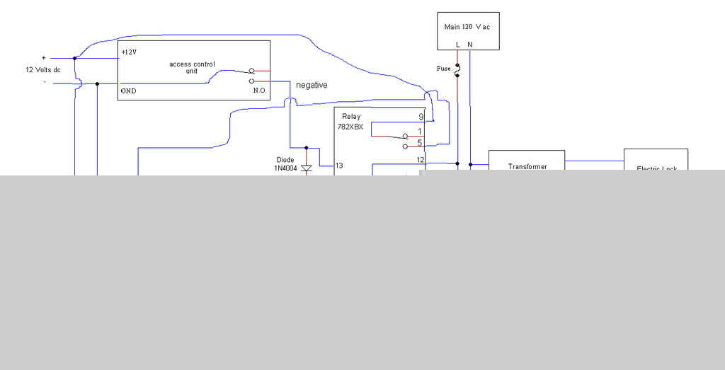

Hi folks. In the attached schematic, does anyone know what model/spec of diode I should add to protect the system from a collapse of the transformer's magnetic field? The transformer's Primary is a 120VAC line, and its secondary is 24VAC, 20 Watts).
Also, what would be a proper model # for the Fuse? That's also a 120VAC line, off of a 20-Amp electrical circuit (12-gauge wire). Probably a 3- or 5-Amp fuse would be sufficient for the load this system will carry.
Thanks!
John

I lost a lot of sleep over a similar question (how to keep from arcing the realy contacts), when I had to run 15 Amp 240V motor with a realy.
Diodes are not the answer, though metal oxide varistors might work fine. The classic solution is an RC snubber, but those are difficult to design and can be rather bulky.
In the end, I found a relay rated to drive motors at that kind of current, and its been cycling 2 x a day for over two years, without a problem.
