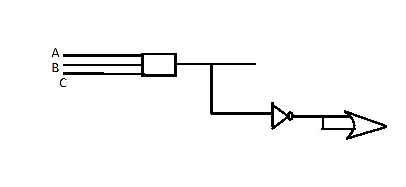

Okay so I think I know where you're going with this... as the warning buzzer will go on when ever all the inputs are HIGH so lets say the warning buzzer is X and Y is the normal operation so X is always opposite of Y and so when X is true warning buzzer is on otherwise for all operations normal condition goes ON.

Hey this is the simplest system I can make now please check it out it is satisfying all the equations as well :)
sorry but I don't know why but I can't upload the image directly here.
http://postimg.org/image/uq9uzxl93/
A warning buzzer and a buzzer to indicate normal operation? That just be one annoying machine to operate! ;)
Assuming the box is a 3 input AND gate, the circuit matches the functionality of your table.
This can also be done with two, 2-input AND gates and a NOT gate.

Hey well the circuit can be further simplified but please no :p I'm happy with this one :p
and the answer is complete right? what do you mean by "Now you can work on making the sensor logic"?
But if the signal labeled Warning Buzzer is always the opposite of what you need for the Normal Light, why can't you use an inverter to generate the Normal Light signal from the Warning Buzzer signal?
In practice, you probably wouldn't even do this, but rather design the buzzer circuit and the light circuit so that one is active high and the other is active low.
By saying to generate the normal light from warning buzzer like this:
and about the second one that one should be active high and the other should be active low...
so that is what's happening in the previous circuit I made right? when warning buzzer was HIGH the other was low that is what you mean by active high and low right?

What's the purpose of the OR gate in your diagram?
You have two active-HI signals. The buzzer should sound when the buzzer signal is HI while the LED should light with the normal signal is HI.
What I'm talking about would be a circuit in which the buzzer sounds if its input signal is HI while the LED lights if it's input signal is LO (or the other way around). Then you can just route the same signal to both circuits.
I understand what youre saying so for active high and low I'll use two and gates with no inverters just AND gates right the OR gate is replaced by AND inverter is removed ao when ever inputs all hihigh warning goes off and when ever any one of the input is low the nornal condition gets a low on it ;) right?
This makes about as much sense to me as if it were written in ancient Greek.
Haha lol sorry about that. What I said was this :
Remove the OR gate and place an AND gate. Remove the inverter as well. So when warning is active HIGH the normal condition is OFF as I need an active low on normal. Right?
I think the direction we are headed here is, what is anything ORed with itself?
a+a = ?
Then realize you are doing this to the normal operation indicator signal.
The "should" wording in your initial post regarding the sensors Ia, Ib, and Ic sounds like requirements which leads me to think you are supposed to design these too.
...to what end?
What is a*a=?
What WBahn is saying is that one would typically make the warning buzzer active high (activated by a logic 1) and the normal operation indicator active low (activated by a logic 0), or vice versa, so the two outputs are determined by the state of a single output.
