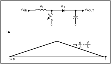

Hello,
When you use this part of the schematic, you will have a capacitor on the DC.
The coil stores the energy and gives it to the capacitor.
The switch shown is the FET or IGBT you use.
Greetings,
Bertus
I hope you do realize that for the above circuit +Vout will be higher than +Vin because the circuit configuration is a boost converter.
I thought the OP is trying to reduce 72V to 12V.:confused:

After staring at it long enough the penny has dropped... Thanks brain :D
However... I am using N-Channel switch, which won't operate on the power supply side... (no positive Volts at gate to emitter/source).
Is there a way to do it with an N-channel switch?
