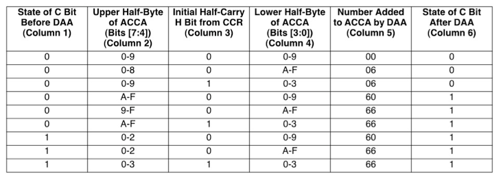

I'm having a little trouble understanding what is going on with this instruction for the question.
Question
The HC12/S12 has a DAA instruction which takes the result of an addition operation and corrects the result to represent the result of a Binary Coded Decimal (BCD) addition. The instruction operations are as de- scribed in the table below.
The two numbers added together are $99 in the A register and $22 in the B register which actually represent 99 and 22 in BCD.
a)What is the result of executing an ABA instruction and the subsequent execution of a DAA instruction in- clude the effect on the carry (C) bit of the condition code register.
Solution
After execution of ABA Register A ___$BB___ Carry bit _______0_______
After execution of DAA Register A ___$21___ Carry bit _______1_______
I understand the addition of the to numbers in bcd (99 + 22 = BB), but what the heck is going on with DAA???
can anyone explain the steps taken? (showing what bits are contributing to the DCC instruction and how they change/why?)
