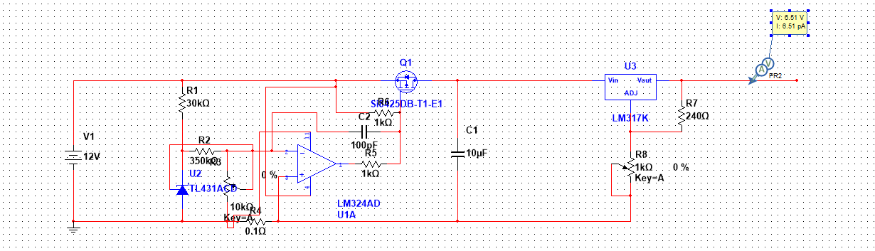

Maybe I've missed something, Tried to simulate the #15 circuit. But i still don't get enough voltage for the regulator. It does work but i do not get the "full" voltage out.
I replaced the zener with a TL431, never used one before so i might have it wired wrong. Excuse the wiring chaos..

Yes the TL431 is wired incorrectly (did you look at the data sheet?).
Connect the control pin to the cathode (top) of the device, not the pot output, which will cause it to drop a constant 2.5V (like a zener).
Also reduce R2 to about 67kΩ.
RE the wiring chaos -- Please take the time to do a clean schematic and spread it out so the designations don't overlap.
It is well worth the effort so one can more easily see how the circuit is connected and help detect any wiring errors.

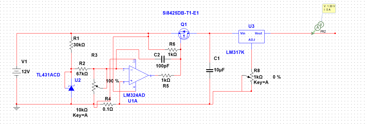

Yes i have spread out all the labels etc so you can see it better now. I think i've wired it correctly. But the voltage is the same. Atm it won't go above 1.3 volts..
Update: when i change the pot R8 from 1k to around 200k the voltage go up to about 10.7 volts (like it should), if i change it to 100k the maximum voltage goes down do about 6 volts.. any idea why it needs to be such a high value? Thanks.
Update once again: Changed regulator from LM317 to a LM723 and now everything works fine! :D

You have U3 connected incorrectly is the reason it won't work properly.
You need a 120Ω resistor (you show 240Ω in your previous schematic) from the output to the Adj pin to be able to control the output voltage.
Incidentally, to clean up the schematic you should also eliminate excess wire lengths and jogs, such as those around the op amp. It still looks rather ratty.

Thanks i will do that too, oooh 120Ω solved it! I might as well ask instead of making a new thread. Everything that i wanted to know about current limiting is now solved thanks to you and a few others!

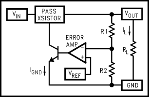

The voltage adjustment scheme for each regulator type is different so you (gasp) need to look at the data sheet for the particular regulator you are using.
The basic scheme for most regulators is a feedback scheme where a reference voltage is compared with the output voltage (often through an adjustable voltage divider to allow output voltage adjustment) using a differential (op amp type) circuit.
The internal series pass element is adjusted by the differential output to keep the output voltage (as determined the divider) equal to the reference voltage.
Below is a basic block of such a circuit.
