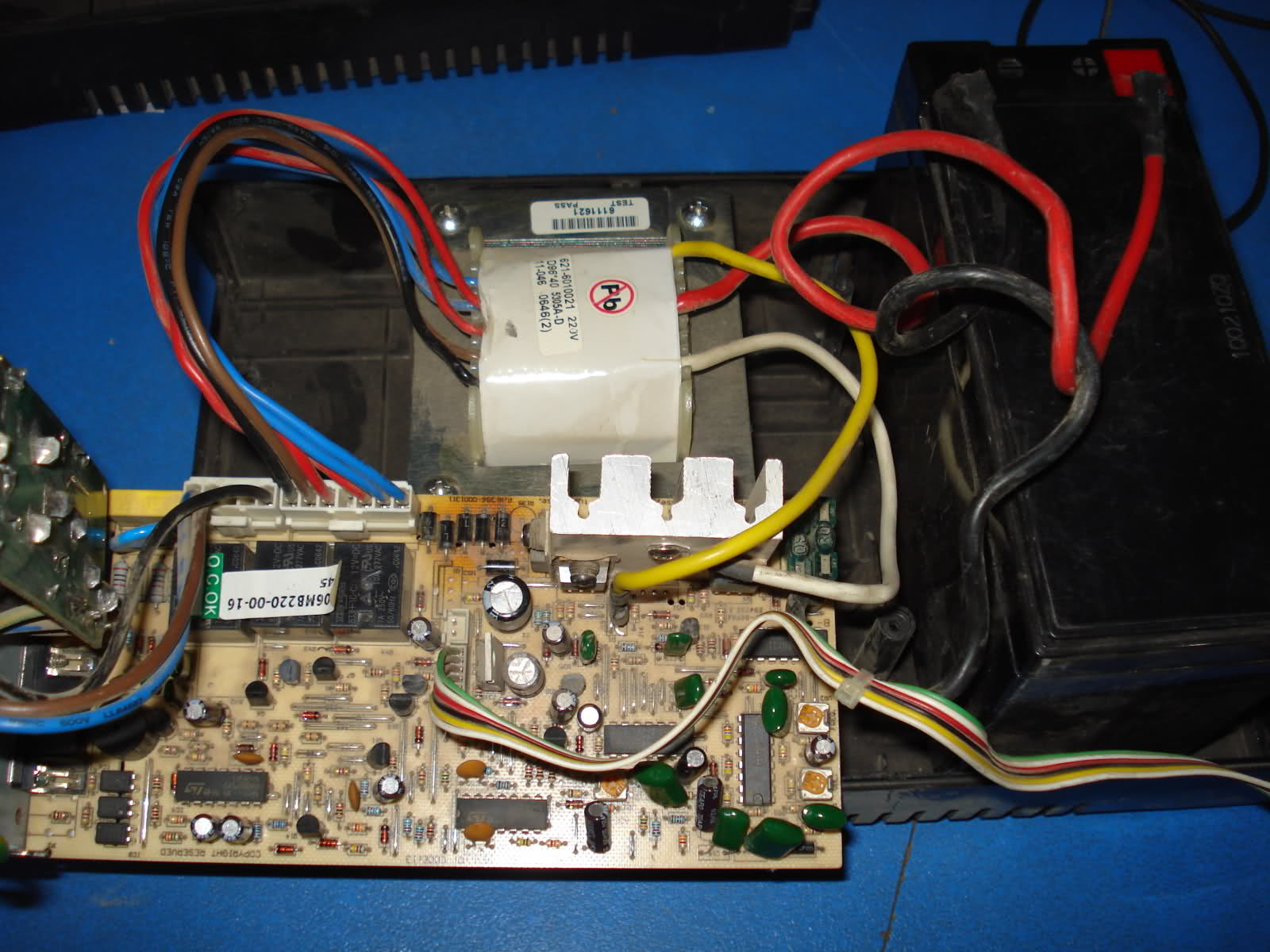

Hi All,
I want to convert my dry battery ups to charge wet battery. Please give me any suggestion how I can do this.
I replaced dry battery about twice but it did't gives any backup (Even of a second).
I can post ups circuit snapshots if you required to assist.

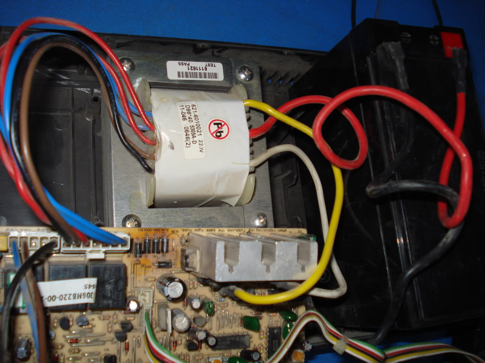

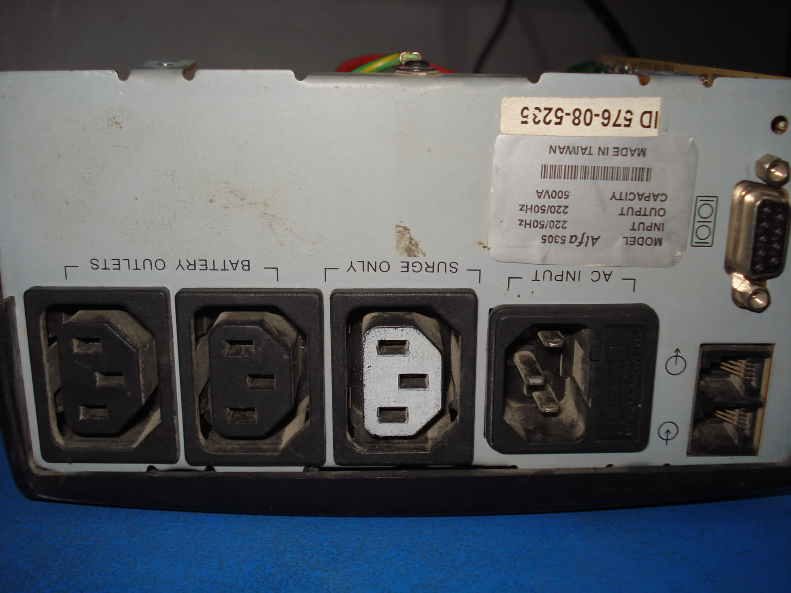

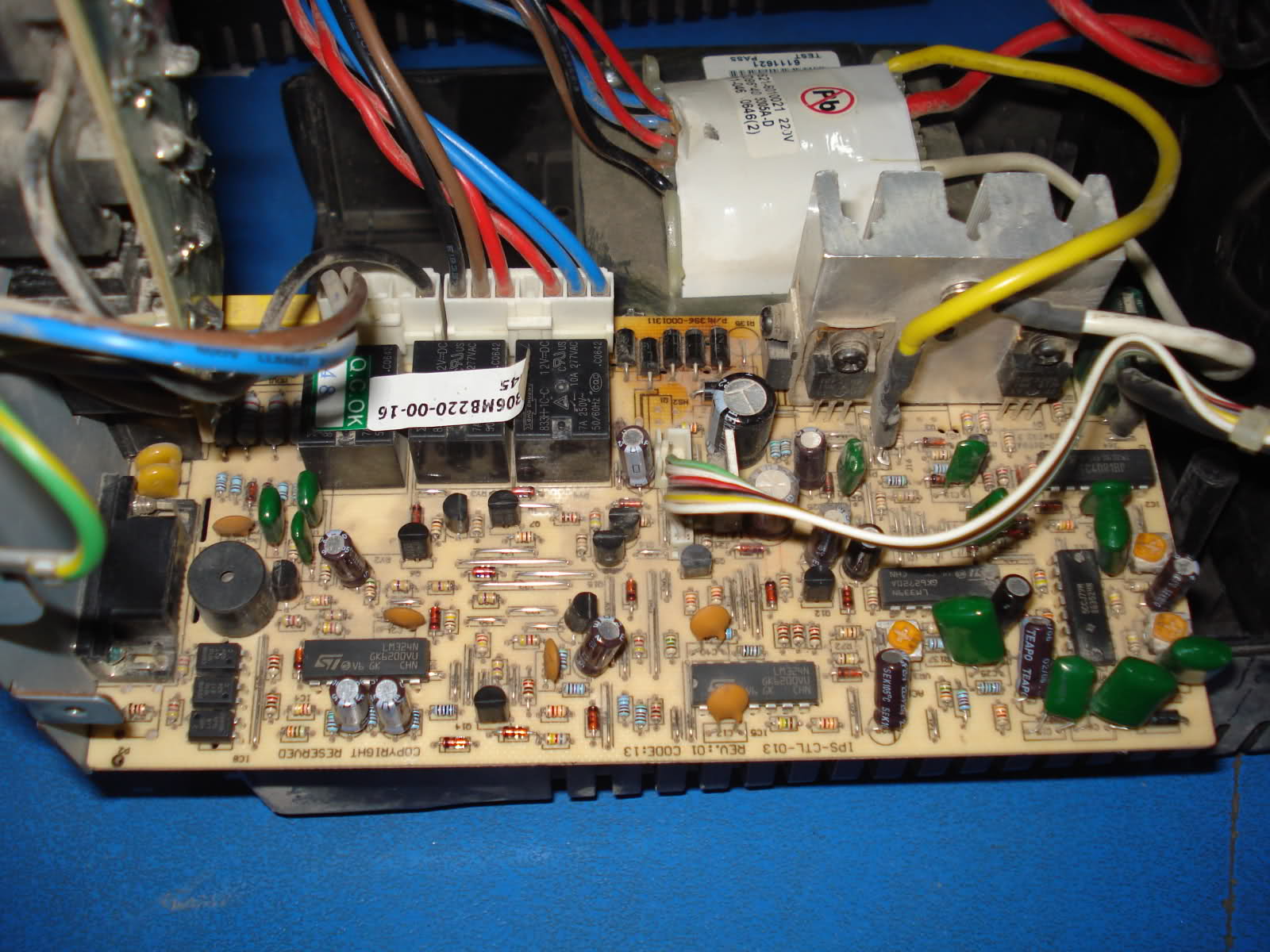

My UPS detail is :
Alfa 5303
Input : 220/50 Hz
Output : 220/50 Hz
Capacity : 500VA
I have also attached images. Please help me to convert it. Thanks

Is the battery a 12v battery? If so, you can replace it with a regular lead-acid battery. It will charge it.
The problem is not in charging the battery. The problem is in USING the battery once you have it charged. If you try to start powering more devices, the UPS cant handle too much more current. The parts will heat up and blow.
If you just want more run time out of it, just switch the battery to your "wet cell". You will want to add a high flow vent fan to the case to ensure it stays cool. These UPS systems are not designed to run for an hour. They are built to get you time to turn the computer off without loosing any work. So if you run it longer than intended, you NEED to cool it.
retched
Joined Dec 5, 2009
5,207
Make sure the fan is blowing on the heatsink, and there is enough holes for the air to escape.
You may end up damaging your UPS if you run it to hard or too long.
