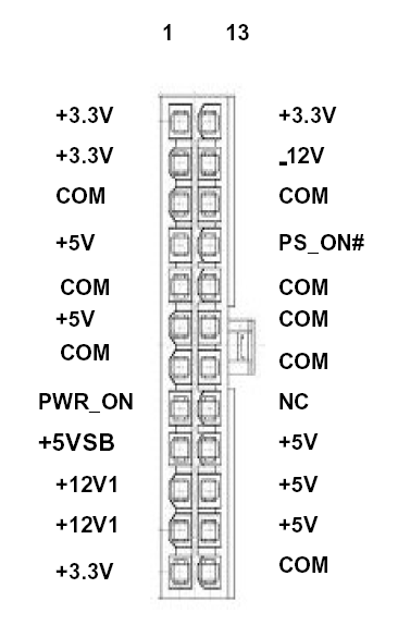

    How can I power a motherboard using batteries without going through the conversion to 110 then back to 12 V (and the other voltages)
    I mean, right now, I have a UPS system that has a 12V battery, the UPS converts that to 110V, then the computer power supply, converts back to 12V (and the other voltages)
    This is the ATX connector for the motherboard, and it shows the voltages it needs.
    [​IMG]
    So, if I have 1 (or more) 12V batteries, how would I connect them to the computer ?
    Any help appreciated.
    Thanks

    The easiest way is to get a picoPSU, as long as your computer doesn't need more than 120W. If you need more power, then try other beefier PSUs, such as the M2-ATX or the PW-200 (look on the left hand side menu on the above page).

    You do realize that the voltages on the connector have to be stable and regulated within a couple of percent. How were you planning to generate +5V, and +3.3V and -12V from one or two twelve volt batteries.
    BTW +12 does not mean greater than or equal to 12 it means +12V plus or minus the supply tolerance. I suppose you could use a marine deep cycle battery but I wouldn't think it would last too long with a 4 GHz. CPU.

    A few posts ago you mentioned using a couple of 12V batteries in series to enable you to still get 12V when each was down to only 6V. Irrespective of what you feed the batteries into (presuming it can cope with an input varying between 2 fully charged batteries giving 27V and 12V) your batteries will not last long if you treat them like this.
    Lead acid cells are not designed for such extreme discharging and many battery charging / control systems actually disconnect the batteries automatically to prevent them being discharged to anywhere near this voltage.

    Manufacturers of high reliability batteries used in standby power systems typically specify a discharge endpoint voltage of 1.75V per cell i.e. 10.5 V for a nominally 12V (6 cell) unit. Though I will stand corrected if anyone can point me at a specification sheet I suspect that no lead acid battery will come near 1V per cell.
    Most standard lead acid cells are just not designed for lots of cycles of deep discharge followed by recharging. A car battery fits this category, normally it just floats across the alternator, it gives a few hundred amps for starting the engine but only for a few seconds which ampere-hour wise amounts to very little (it is not just a straight multiplication though since at high discharge currents battery efficiency is reduced and the nominal ampere-hour capacity could easily be reduced to 25% of nominal) and then gets topped up again by the alternator in the next few minutes.
    Some batteries (deep cycle types - sometimes called leisure type batteries) are designed for multiple charge / discharge cycles.
    I am not saying a battery will necessarily be instantly destroyed by a deep discharge if it is recharged soon afterwards but the number of charge-discharge cycles and the battery storage efficiency will be adversly affected if this is a repetitive event.
    Actually this is not as bad as it may seem - the battery will maintain a decent output voltage whilst its ampere-hour capacity is used up, and hence there is not much more energy to be extracted by allowing the voltage to fall to 6V.
