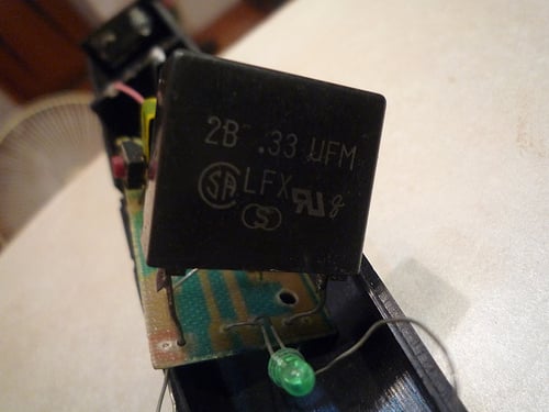

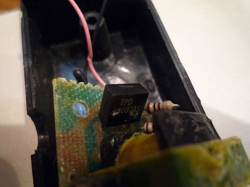

I am trying to fix my electric bug zapper and with the aid of my limited knowledge in electronics, I figured out the circuit is about 3V supply from the battery which got stepped up by the transformer and gives out a current and that's all.
There are two components I need help with : (see pics)
that TPD1007AS I could not find the datasheet for it or pinouts.
for the big fat box, I don't even know the component name to search, but it looks like a voltage regulator.
thanks

On the parts3 photo I see a capacitor of 0.33 uF.
Beware of the high voltage a bug zapper can make.

The TPD chip is probably made special for the producer of the big zapper and will not be found on the market.

'Big fat box' is a capacitor.
TPD1007 is probably a transistor used for oscillation.
The whole circuit is a simple oscillator using the transformer for feedback and step-up.
