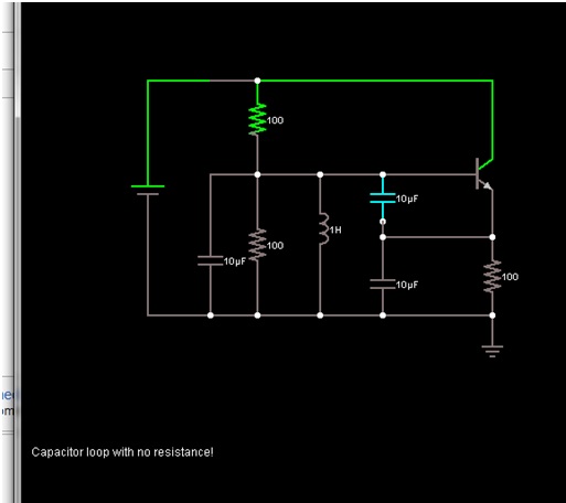

    Hey guys,
    Ive been asked to design a Colpitts Oscillator in a common collector configuration using a single BJT. Im really new to this so help is greatly appreciated :)
    Vcc = 12v
    Frequency has to be 4K Hz
    Vout = 3V
    Now i know that the formula for frequency is
    fo= 1/[(2*pi)*sqrt(LCt)]
    and Ct = c1*c2/c1+c2
    How would i work out the values for L and C ??
    Ive been looking around the forum and I cant seem to find any information about Colpitts Oscillator in a common collector configuration.
    I know this is the basic layout of a common collector colpitts oscillator but what do i need to add to the circuit to make it functional? Does Vin go to the collector or the emitter?
    [​IMG]
    Any help would be greatly appreciated :)
    Cheers guys.

  5. s15kid
    Thread Starter New Member
    Oct 16, 2011
    10
    0
    Ok so get rid of the top capacitor and connect it straight to the collector and ive added a coupling capacitor which i think is right.
    [​IMG]
    why does it say that the capacitor loop has no resistance? do i need 2 place a resistor somewhere there?
  6. Hi-Z
    Member
    Jul 31, 2011
    157
    17
    No, remove the leftmost capacitor. Disconnect the L and "top" C from the base. Connect them both to a capacitor, and connect the other side of the capacitor to the base. Hope that's clear!

  8. Audioguru
    New Member
    Dec 20, 2007
    9,411
    896
    Now the base has no bias voltage. Connect the base to the voltage divider.
    Change the resistors in the voltage divider to 18k ohms each.
    Change the emitter resistor to 1k ohms.
    The frequency is the resonant frequency of the inductor in parallel with the two series capacitors. The formula for capacitors in series and for a parallel LC resonance is in Google.
    There is nothing to stabilize the output level so the transistor will clip the signal and it will be almost a square-wave.
    s15kid likes this.
  9. Adjuster
    Well-Known Member
    Dec 26, 2010
    2,147
    300
    The value of Ct should be chosen large enough so that its reactance Xc = 1/(2πfC) is many times less than the input impedance of the transistor circuit.
    Don't go too wild with the "large enough": think microfarads, not millifarads. Capacitors suitable for resonating can be inconvenient in large values: electrolytics won't suit this job.
    If you get your oscillator to work, but with a rotten waveform, a small resistor in the lead between the emitter and the junction of the two capacitors forming Ct may help. Do not make this too big, or the oscillator will not run any more.

  13. Audioguru
    New Member
    Dec 20, 2007
    9,411
    896
    Since you have an extremely low value resistor divider feeding the base of the transistor and shorting the tuned circuit, and you don't bias the base of the transistor, andyou don't power the collector of the transistor then of course the circuit won't work.

  16. Audioguru
    New Member
    Dec 20, 2007
    9,411
    896
    The base of the transistor still does not have a bias volltage.
    The resistance of the coil still shorts the voltage divider to ground.
    Why is your schematic a negative picture with a black background?
    Why are the wires covered in dots?
    Why doesn't it show a power supply voltage?
    What is 1mF? How many uF?
    I think the ratio of the capacitors at the emitter determines the output level.
