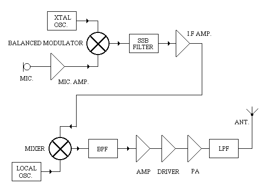

ELECTRONERD
Joined May 26, 2009
1,147
Usually you have a mixer whose inputs are from an audio signal (amplified of couse) and also an oscillator that sets the carrier frequency. That in turn goes to the RF amplifier. Below you'll find a block diagram, this version includes filtering and an I.F amp. The mixer is the cirle with the big "X" and notice that the oscillator and audio go into the inputs. Thus, you have a modulated signal. So you would use your Class-C amp for the audio and input that to the mixer and also the oscillator to set the carrier.
