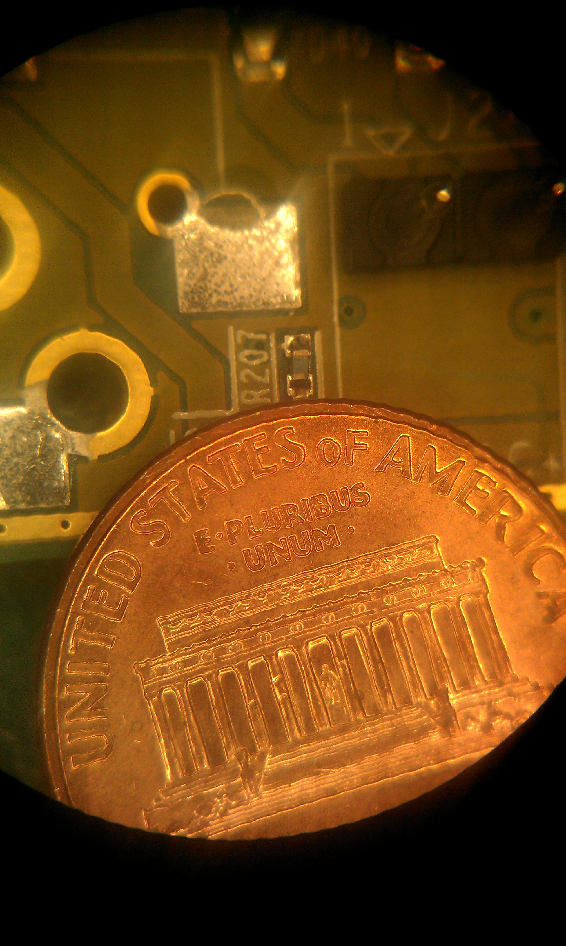

Before you build this, you do realize that all of the BOM parts are SMT, right ?
Building this with the exact parts provided is beyond of capabilities of 99% of EE students, unless you own a circuit manufacturing company..

For 6 years, i worked in circuit board manufacturing plant (Creation Technologies Inc), I seen how it's done.. If you are capable of doing it yourself, then you have a talent there..
bushrat
Joined Nov 29, 2014
209
It's possible, but the question is, have YOU done it before?
Just because youtube shows how to do it, does not mean that you have the capability or knowlede to do it.. I seen a guy on youtube benchpress 500 lbs, can i do it too?
R207 is a 0402 component.. picture taken by me under microscope. A penny to scale (I know, it's not a banana)
