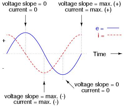

    In this case the capacitor current will be first.
    As you should know the capacitor oppose the change in voltage by supplying or drawing current.
    Capacitor current is proportional the rate of voltage change across it (proportional to how quickly the voltage across capacitor is changing).
    The faster the voltage change (frequency of a AC signal is high) the large the current flow through capacitor.
    I = C * dV/dt
    This means that to sustain current through a capacitor the applied voltage must change. The more rapidly voltage changes the larger the current. On the other hand if voltage is kept constant no current will flow no matter how large the voltage.
    Likewise if the current through a capacitor is found to be zero, this means that the voltage across it must be constant, not necessarily zero.
    In outer special case the voltage is a sine-wave.
    So the rate of voltage change reach maximum when voltage signal crossing zero. And the rate of voltage change reach minimum when the voltage is at a peak value.
    [​IMG]
    [​IMG]
    So in your circuit when V1 reach +5V the current in R1 reach his maximum value.
    The capacitor current also will be at peak value and capacitor voltage will reach zero (2.5V).
