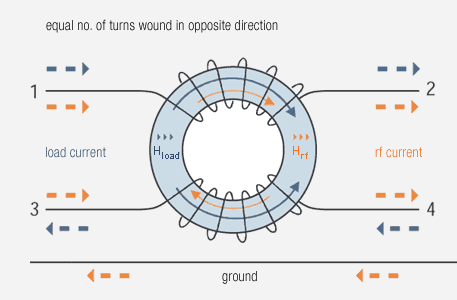

I realize that you might not be aware of what a common mode transformer is (lots of DC brushed motors in pro equipment have them):
Here's a drawing of one - notice how the wires are wound in opposite directions, to cancel common mode signals (the noise, orange arrows), while passing differential mode signals (the power to the motors).
You can make one yourself (a ring core from an old PC psu or similar would do) and place it close to a motor with eg. a 100nF cap on each side.
The more windings the better. Remember to wind them opposite of each other.
