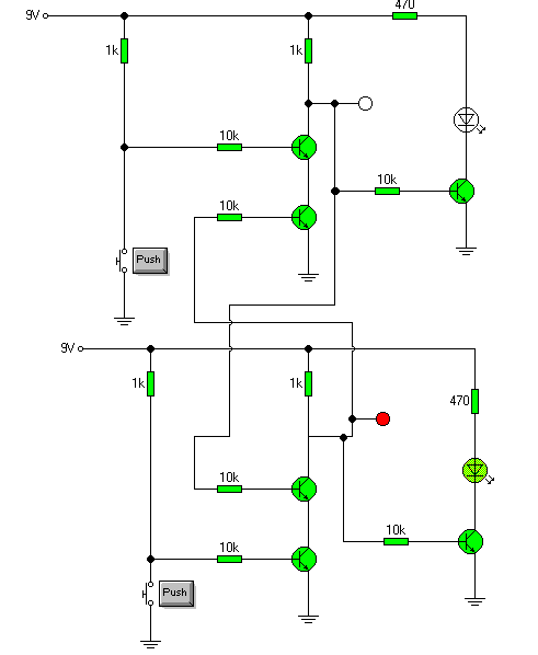

Ok, thanks a lot both of you. I think I'm starting to understand things a bit more... However, after reviewing what you guys said, I still can't get the following circuit to work (2 NAND flip-flop):
The current through the LEDs is 3,75 mA when ALL gates are open (sorry, the image has one gate closed, but the current through the LED is 3,75 mA when this one is open also). I have no idea how this is possible. I would expect 10 mA, since I calculated the following: U = 3V, I = 0,02A, so R = U / I = 150 ohms. Yeah, I forgot that the current would be split (that's true, right?), so wouldn't the current be 10 mA then?
I don't understand the other values either, so could anyone please explain to me how to tackle the circuit analysis of this circuit ?

This circuit (if I'm right at least), is a bistable flip-flop, and I want to use it as a memory cell. However, the problem is more general in my case:
I can't find a way to get multiple combinational gates (NAND gates in this case) to work together. For some reason, each time I connect the output of inverter A to the input of inverter B, both turn off. This is most probably due to wrong resistance values. So my question is: How can I calculate the correct values to use when I want to use them in such a situation.
Also, I don't understand why the simulator came up with such a strange current: 3,75 mA, while I would expect something like 10 mA. Once I understand why that is, I might also be able to answer the previous question, so answering either one works for me :)
Thanks in advance!
Regards,
Abel.

You circuit don't work propriety because you design it not quite right.
Look at proper design BJT "NAND" gate:
And simple RS flip-flop using only two BJT
And RS - flip-flop with BJT "NAND" gate
And in your circuit when all BJT are cut-off then you have two LED connect in parallel with 150 resistors in series connect to 3V power supply.
So from II KVL we have
Vcc= I*150Ω + VF
then if we assume VF = 1.6V then:
I = (3V - 1.6V) /150Ω = 9.3mA
So led current wll be lower then I_led = 9.3/2 (two diode in paraller) < 4.6mA, we don't know exact value, because we don't know the exact value for a diode voltage forward drop VF.

What does VF mean? Is it the collector-emitter voltages
of the two transistors in series added together?
VF is a LED forward voltage drop.
Collector-emitter voltages it would be Vce.
So did you use a 3rd transistor in order to draw higher
current through the LED ? Does this also prevent other things
from interferring with the LEDs current and voltage?
Well, yes.
This extra BJT acts like a "buffer" which separates LED from NAND gate.
Thanks to that extra BJT the LED does not effect the proper operation of the NAND gate.
How did you come up with the resistance values? The base resistor
value is chosen to draw one-tenth of the collector current, right?
Yes you right.
I always use Rb = Rc/( 0.1....0.5*Hfe_min) = Rc/ (10...50) to ensure saturation.
I wasn't able to create the second circuit in Yenka. What program
did you use?
Open the attached file in Yenka.
And the program I use is a older brother of a Yenka the crocodile clips.
http://www.mikrokontrolery.net/pawel/crocodile clips.rar
In the last circuit, when I change the 1K resistor values to lets say
100K, the current through the LED doesn't change (nicely done! :D).
Why is that?
That thanks to 3rd BJT and his current gain Hfe.
For example if BJT has Hfe=100 then for R =1K:
Base current is equal
Ib = (Vcc - Vbe) / (1K + 10K ) = ( 9V - 0.65V )/ 11KΩ = 760uA
And collector current
Ic = 100 * 760uA = 76mA
But in oner circuit is impassible to have Ic = 76mA because the max Ic is equal:
Ic_max = (Vcc - VF)/Rc = (9 - 2V)/470Ω = 14.9mA
So this means that BJT is in saturation.
And in saturation Ic = hfe * Ib don't hold anymore.
So in this circuit
Ib = 760uA
Ic = 14mA
Ie = Ib + Ic
And now if we change 1K resistor to 100K we get:
Ib = 8.35V / 110k =76uA
and Ic = 76uA * 100 = 7.6mA
And this time BJT is not in saturation because Ic < Ic_max.
So Vce = Vcc - VF - Ic*Rc = 9V - 2V - 7.6mA *470Ω = 3.4V
http://forum.allaboutcircuits.com/showthread.php?t=24314&highlight=saturation
http://forum.allaboutcircuits.com/showthread.php?p=166105#post166105
