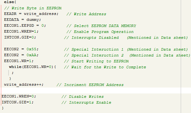

    I am writing data to EEPROM at 9600BR. I am using HyperTerminal to transfer characters. When i transfer 3 character at the same time, Its works but the problem arise when i try to transfer greater then 3 bytes at the same time. Therefore i've done calculation to see where the problem lies.
    (The screen-shot of the Write Module in given below)
    1) My MCU Freq = 4Mhz, Each instruction takes 4-cycles so write module have 13 instructions (see the screen-shot), instruction will take 13usec (13/1M) & Instruction time + EEPROM Write time(10ms) -->Approx 10.013ms.
    2) 4 bytes should take around 40msec (13u*4).
    3) I am using BR 9600 bits/sec; converting to byte will be 1200 bytes/sec(9600/8) means --> 1 byte will take approx 833usec (1/1200) to be on the bus.
    I may be missing something...
    Any help would be appreciated.
    [​IMG]

    There are two big differences between this example and your code. One is the way that interrupts are saved and restored. The other is the bit that's being checked to see if the write operation is completed. This example is from a code library at this site (2 pages) https://electrosome.com/internal-eeprom-pic-microcontroller/1/

    I just want to know why it accepts the 3 characters & writes in EEPROM at the same time But NOT 4 characters ?

    I'm guessing it is because your receiver is being overrun because you are not buffering the data. Also I'm guessing that the EEPROM Write is not overlapped with the reception of characters. Busy waiting is a bad bad thing!

    +1 It is hard to say exactly why it quits when it does but as you know, writing the EEPROM takes a couple of mSec and the code waits on that. 9600baud is roughly 1ms/char. The best (only) way to get this working is with an interrupt driven FIFO buffer that is big enough to hold the characters received until you process them.
    An easy way to make a FIFO in C is with an array of characters with two indexes, one that keeps track of chars put in and another to keep track of chars taken out. A separate counter keeps track of the number of characters in the FIFO. It is incremented when a character is received and decremented when a character is read. The UART is configured to interrupt the PIC when a character is received. The service routine reads the character then puts it in the FIFO. It then increments the counter and the index, wrapping it when it reaches the end of the array.
    Reading is similar. If the counter is >0, read the character at the current index, increment the index with wrapping and decrement the counter. The UART interrupt must be temporarily disabled while reading the FIFO.
    Good luck.

    John outlined the basic receive mechanism of using a FIFO buffer. That is an acronym for First-In, First-Out. What this means is that if the five characters in the string "hello" come into the UART Receive hardware, one after the other, in that order, then your firmware reads them from the hardware in an interrupt routine and "puts" them in the FIFO buffer in that order. Later another process will come along and check how many characters are in the FIFO and it finds there are five. So it "gets" or removes them from the FIFO one at a time in the same order as when they originally came in.
    The second part of what I was suggesting was to overlap the EEPROM writes with other things. You do this by avoiding infinite loops like

    In general try to do anything at all to avoid waiting on a single condition that may or may not ever happen.

    If you enable GIE inside the interrupt routine you will hose things up in a major way by allowing the stack to be overflowed with multiple unserviced interrupts. GIE must remain disabled for the entire length of the interrupt routine.
    The instruction RETFIE is supposed to do two things:
    1. Return from an interrupt, by placing the value on top of the stack into the program counter.
    2. Re-enable interrupts by setting GIE=1
    If the stack is empty and there is no return address to go to the processor is very likely to malfunction. The only way this could happen is for a RETFIE instruction to be misplaced in the execution sequence. It is much harder to do with a compiler watching out for you. It is much easier to do if you code in assembly language.
    OMG -- I just realized you are trying to do the EEPROM write inside the interrupt routine. Go back and reread my earlier posts.
    NO --- NO ---- NO ---- you must not do this!!!!
    The time you spend inside an interrupt routine is a critical resource. You must only receive the characters inside the interrupt routine. Get in and get back out as fast as possible. The writing of the EEPROM must take place outside the interrupt routine in the non-interrupt level code.

    @Papabravo : I get it. I should only (receive+store in buffer) the characters in the ISR & Writing should be done in Main function.
    I thought about it first, but i was avoiding the "Polling Approach" therefor i thought about writing EEPROM in ISR. I will be doing other tasks on the same MCU e.g. i will be monitoring External Interrupts + some other task to done. And EEPROM write should be done by user via SMS, so it can happen anytime. Either i have to poll it every-time or i have to use interrupt for it.
    But you are right, i shouldn't wait in ISR
    Now it works fine, Thanku very much for the help :)
