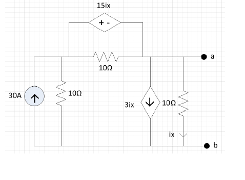

hello!
how i calculate the R thevenin ,if i got positive V open circuit, and i got negative I-short-circuit. is it correctly to calculate with the absolute value of I-short-circuit?? (beacause the minus sign of the current is just to show direction?)

The image is not clear but your answer in Voc is wrong.
Voc is the voltage across the source 30Ix and the resistor 10Ω in series. Therefore,
Voc = -30Ix + 10*(-1.5Ix) = -45Ix.
To find Isc you can use KCV at the top-right corner of the circuit.
How can you know 1.5Ix * 20 = -30?
You forgot the voltage across current sources.
PS. Can you rewrite your works about Voc here?

Also Rht answer is wrong.
Rth = 300V/10Ω = 30A
I also don't like you transformation the 15IX CCVS into 1.5Ix CCCS.
Jony130
Joined Feb 17, 2009
5,488
I use nodal analysis and I write the two nodal equation
30A = Vx/10Ω + 3Ix + Va/10Ω
but Ix = Va/10Ω
so we have
30A = Vx/10Ω + 3*Va/10Ω + Va/10Ω
and one additional equation for supernode
Vx - Va = 15*Va/10Ω
and we have a solution for Vth
The Vab = Vth = Voc = 600/13 = 46.1538V

Contrary to conventional wisdom, it is interesting that one can find the Thevenin voltage using superposition. It is often argued one cannot use superposition in circuits where dependent sources are included.
The process as I see it ...
For the 30A current source, the contribution to ix is 15A
For the 3*ix dependent current source, the contribution is -3*ix/2 or (-1.5*ix) Ampere
For the 15*ix dependent voltage source, the contribution is -15*ix[Volts]/20[Ω] or -0.75*ix Ampere.
So from superposition one may write
ix=15 -1.5*ix-0.75*ix
or
ix*(1+1.5+0.75)=15
and
ix=15/3.25=4.615385 Ampere.
giving
Vth=10*ix=46.15385 Volt.

You get wrong answer, because for me this "source transformation" done by amichayfeldman don't work as expected.
Conversion 3Ix current source into voltage one should work. But I don't know why this also don't work.
But I complicity don't like the way he transform the 15Ix CCVS into 1.5Ix CCCS.

Uhm, I see what is wrong here. A voltage source with parallel resistor can't be transformed to a current source with the resistor in series.

I have some more thoughts about this 3Ix CCCS into CCVS 30Ix source transformation. And I think that I know the answer why in this case this transformation don't work. Because after transformation the Ix current that flow through 10R resistor will change his value.
See the example
Before source transformation IR1 ≈ 833.33mA and after transformed a current source with a parallel resistor into voltage source with a series resistor. IR1 change his value IR1' ≈ 166.7mA.
So our Ix current change his value so this source transformation is not aloud.
Because we have a current control sources in the example.

Hi Jony, I think it will work.
Thevenin-Norton only make sure that voltage and current at terminals unchanged.
After converting 3Ix CCCS into CCVS 30Ix source I think we can continue to figure out Voc.
PS. In your image, I calculated the voltage at the node is 11.66666V. The current flows through R1 is not the same in the two circuits but the voltage and current looking into pair "current source and R1" and "voltage source and R1" are the same.
I would like to see how?
In witch node you find 11.67V??
Yes, but in our case Ix is control current, so after transformation we change transformation current. So how can this transformation holds ?
This can work only if after transformation Ix don't change his value.
