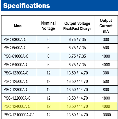

I just purchased a pair of 12V 35AH AGM Batteries for my mobility scooter and
looking to build a charger for them that meets or exceeds the batteries charge requirements and cost much less than buying either the manufacturers charger or a suitable equivalent.
I'd like any ideas or suggestions you all might have on how I could accomplish this.
The batteries are connected in series in the scooter, providing a 24V source for mobility. For optimal performance and longevity, however, I would like to charge them separately and thus will have to double the components.
I will also need to make a switch to "re-wire" the batteries from a series config to a standalone configuration.
Links to Info/Specs:

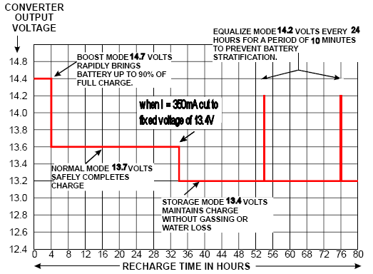

From this information I would like to simulate a charging method similar to the picture below:
There are a few options for building, without micro-processor, with microprocessor, or with some Battery Management Charger, Chip.
Not sure which way i will go...am hoping to get input and ideas from all of you.

Here's how I might try it:
Use either a transformer and bridge or brick supply to get about 17-18V and 3-6A output after a bank of caps. Feed that to a lm317 with pass transistor and some output caps. This will give you a 3-5amp power supply that you can regulate the voltage output by using the microcontroller and a digital pot or some other method to alter the voltage at the lm317's adjust pin. The output of all of this goes through a 0.01ohm shunt.
Use a small microcontroller for the timing and current measurement. Measure the output voltage (voltage after the shunt) using an ADC pin on the microcontroller. Calculate the current by measuring the voltage before the shunt using another ADC pin and compare the two voltage levels. The difference between the two voltages can be used to calculate current.
The hardware isn't hard, the firmware would be a little work, but not too much. You need a delay routine that can last for 24hrs or 10 min. You need to do the adc conversion and then map the results to actual voltage levels.

Yes indeed this chargers you mention here is an alternate, not specifically intended for these batteries. It was merely the charge sequence I was interested in mimicking here. The battery Manufacturer's specs call for no more than 10A... The particular charger recommended for the batteries is the PS-124000A-C. It's specs are:

El3ctroded,
The manufacturer of my Batteries, PowerSonic, makes both a transformer and switching supply version. I was more inclined to reach for the Switching Supply. I've actually found a much better price for the charger(PS-124000A-C) from Mouser.... $98.00, for two $196.00. This is much more reasonable than $175.00 for 1 charger.
