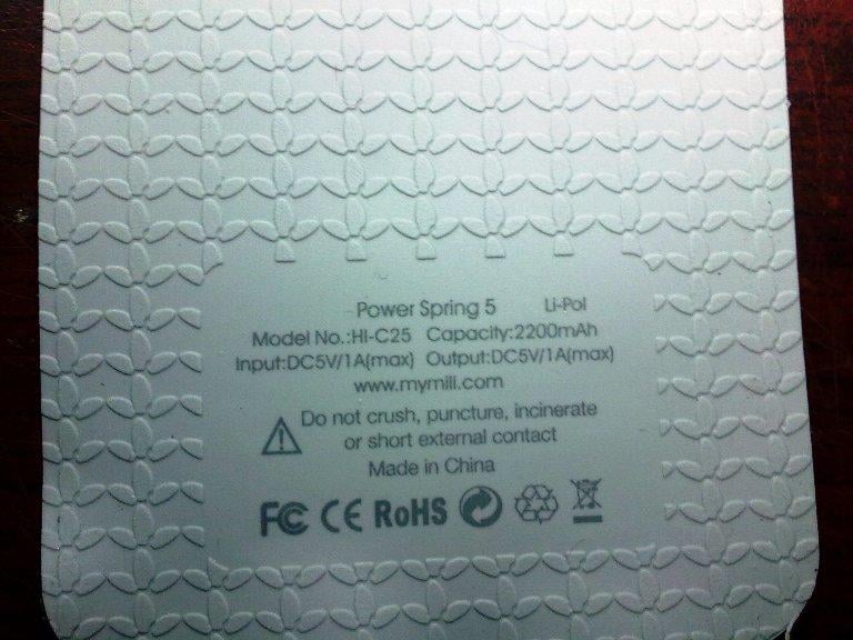

hi every one im glade i found this amazing forum. its realy useful. i get a rechargeable battery for iphone from a friend. the board charge the battery but its not charge the phone. i dont wanna to fix this one. i want to use this battery to run my flash light its need four AA battery.
can u help me please how to designe a board its charge the li-pol battery and run my flash light. but i dont wanna to destroy my light.
thank u.
this is the pic.

im searching from 3 days i couldnt find any thing. if there is a board sample i can find the component and solder it together.

That battery in the picture is bulging.
Check it, if it is like a pillow then you cannot use it. It's faulty.
Second we need to know whether you have a lipo or li-on

thank you for keeping up with me. the battery is not bulging. its perfect like new one. the mobile phone camera im using is too old. the battery is lipo. i dont wanna to charge the battery with AC 110v. i will use dc 5.0v charger.

the battery has 2 wire black and red. its full charged. its give in those wire 4.11volt, 8.33a. capacity 2250mah. i want to use 5.0v or 3.7v dc charger too charge the battery, and over charge protect. and the flash light use 4pcs AA battery.

Then it is a 3.7V lipo. Fully charged will give u 4.2V.
U cannot use 3.7V to charge unless you have boost circuit to increase the output.
It will be easier to use a 5V PSU.
Now it's up to u to do a home work.
Search for Lipo charger circuits and learn about it's charge chemistry.
I have not done a lipo charger but I did a Li-on charger for my battery drill.
But I do not think it is impossible
Try google and decided what appeals you. Then show us what you decided.
I do not have time to design anything these days. I am in the middle of a project but I can advice on anything possibly. You need to do the hard part. It will help you to learn.
