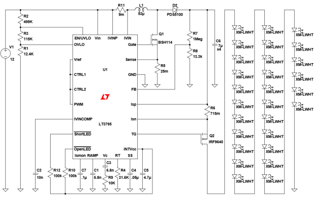

    All,
    How's everyone doing? I hope everyone is doing well.
    I need some help with the method/formula for selecting an out capacitor for my boost regulator. Any help is greatly appreciated.
    In the manual for the LT3795 everything has a description with formulas for selecting all the components, except for the output capacitor.
    I'm getting a nasty current ripple and need help to mitigate it!
    Vin = 12vdc
    Vout = 95vdc
    Iout = 350ma
    Fsw = 250kHz
    Inductor = 53uH
    Cout = 7uF
    Here's a photo of the ugly ripple, ha ha. And the schematic. If you guys need anymore information let me know! Cheers!!!
    [​IMG]
    [​IMG]

    Can you post the .asc file?

    It's an LED driver? why do you care about the moderate ripple?

    Thanks for the replies.
    Here's the file. And that's this issue, ha ha. I don't have enough experience to know what's acceptable.
    But my circuit has much more current ripple than the one that comes with the sample circuit for the uC.
    How can I attach it, tried zipping to 7z and .zip, doesn't show up as an option.
