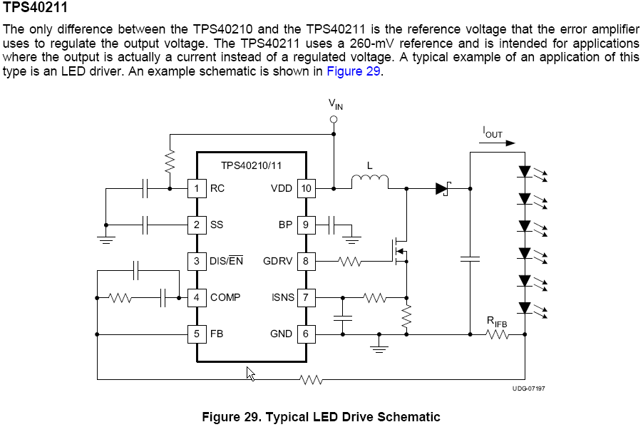

I am building a DC-DC boost converter off of the LT1172. This boost converter is supplied by a 9v battery and has an output of 40v, which is what i wanted, however. (There is always a however)... When I hook the boost converter to my 145 5mm LED array and each led is 3.3V at 20mA the voltage begins to fall until my leds no longer light up, when I unhook the array of LEDS the voltage jumps right back to 40V. Why does this happen and how do I keep this from happening?
