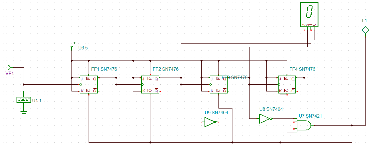

I was told to do a BCDCounter for 0 to 9 and after 9 it will reset and start over from 0 again. No reset switch are allowed and resetting should be done in the circuit without using a switch as reset. I don't understand which part I had done wrong and just couldn't get the 7 segment display to even display the numbers.
Did I connect something wrongly??? Help would be appreciated

The "RESET" of your JK F/F 7476 is active low. You either need a 4-input NAND for your U7 or add an inverter gate on the output of 7421.
Your BCD counter would only count 0-8 and resets on binary 9 or "1001" binary.

There are a few issues with this circuit -- not all of which may show up in simulation.
You are decoding four signals looking for a match to a particular pattern and, if that pattern is seen, you perform an asynchronous reset of the circuit.
In general (say this was a synchronous counter, other than the reset part), the outputs can change in any order.
So, for instance, when it goes from 7 to 8 it could go
0111 -> 1111 -> 1011 -> 1001 -> 1000
And you could see a decoding glitch that is long enough to reset the circuit.
Since this is a ripple counter, you will see it go
0111 -> 0110 -> 0100 -> 0000 -> 1000
Next, because you are resetting as soon as you see 1001 (and let's assume you don't have any decoder glitch issues), then your counter will just barely enter 1001 and immediately reset to 0000. This will happen so fast that you won't notice the '9' on the display at all and it will look like it went from '8' to '0' (as a previous response noted).
Finally, and this is why you aren't seeing anything happening, is that your reset inputs are active-LO and your AND gate produces a LO signal (and hence resets the counter) in every state OTHER than state 1001 (as a previous response noted).

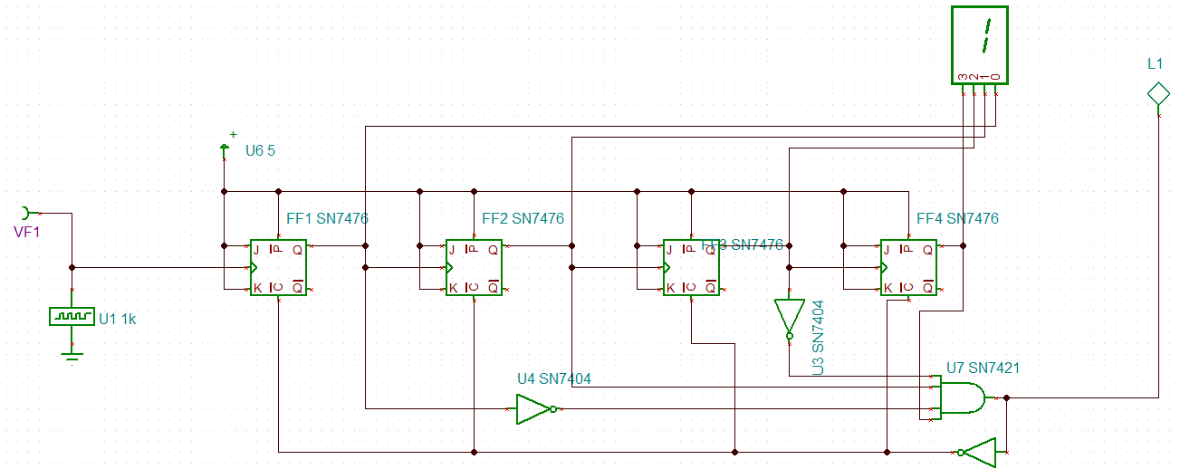

I manage to get the circuit to run from 0 to 9 and reset but I still don't quite understand , you can see that i invert the first and third JK flip flop so they can become 0s later. But I still don't understand what exactly i'm doing.
Can someone explain to me what exactly did i do? I get the answer but I don't understand why I manage to get the answer.

For the most part, you did what we told you needed to be done. You inverted the AND output because the reset is active-LO and you wait until you see state 1010 (i.e., 10 or 'A' in hex) to reset so that you get to actually see state 1001 (9).
This is essentially what is happening to your counter state as you approach reset:
777777777788888888889999999999A0000000001111...
Before, what you were seeing was more like
7777777777888888888890000000001111111111222...
As you enter the state that you have decoded, you only stay in that state long enough for the AND gate to assert its output, the inverter to invert it, and the reset inputs of the flip flops to act on it. With today's ICs, that whole process probably takes a fraction of a microsecond.
