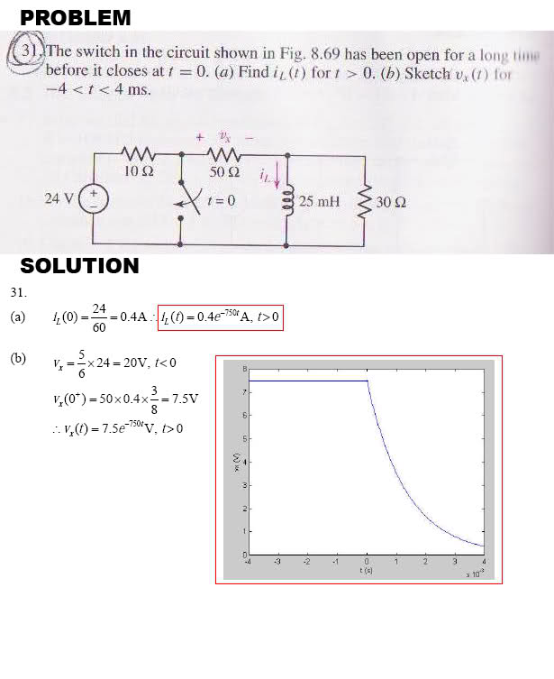

From what I understand when t>0 the switch is closed. When it is closed the inductor goes away... is this correct?
When I solve for iL(0) I get 24/90 instead of 24/60.
I also get iL(t) = 0.26e^3600t
As for part B I am completly lost where did they get V = (5/6) x 24 = 20V from?
Please help guide me thanks!
