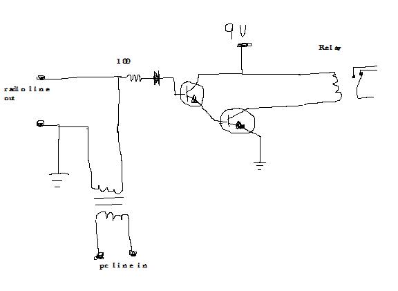

i have a set of baofeng radios i am interfacing with echolink. i have isolation transformers on both audio channels and serial activation of the ptt on the radio but i want to be able detect when the squelch is open and send a serial signal back to the computer. i'm trying to design a circuit to activate a relay off the audio out of the radio. it works if i don't have the isolation transformer connected but when i connect the transformer it stops working. any help would be appreciated.
