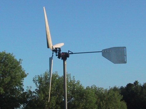

    I am not suggesting perpetual motion with the hydro generator..... the output of the pump can be used to drive a water wheel to turn the generator, with the combined power from solar, hydro, and wind all going into the battery banks to charge, the combined output will be pulled down to the battery levels anyway while charging, as long as he puts in a blocking diode for each source before going into his charge controller..... but most likely he would have to change charge controllers also, since all solar charge controllers are not very efficient, when the battery reaches a full charge the controller just shorts out the output of his panel which is wasted and dissipated as heat through the transistors.....

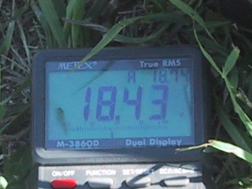

    I have a setup at home with a micro windmill generator and a hydro generator to charge a bank of 3 12volt 21AH Lead Acid Batteries ( I use the power for outdoor lighting).... the hydro generator is just placed over a natural creek that flows near my property (the hydro generator is built on a platform that lowers or raises with the water level...), and the flow of the water turns a water wheel with an output ratio of 1 to 10 to the generators shaft (1 turn of the water wheel = 10 turns on the motor shaft).... and at about 30 rpms on the water wheel, I am getting around 18 + volts output on my PM DC motor (rated at 90 volts DC, 300 RPMs).....
    And as for the windmill, I am not talking about some gigantic 100 Meter pole windmill, mine is mounted on a 10 foot pole, [​IMG]
    (with a 87" swept area and produces 18+ volts in 4 to 7 MPH winds...)
    [​IMG]
    and they do make smaller ones just for pond aeration and such......
    Besides I was just throwing some ideas his way anyway...... and we will probably never know what he thinks of them unless he comes back around....
    My .02
