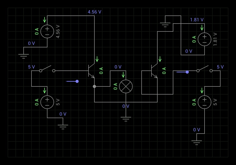

So I am making something using my arduino uno. The problem is that I need 24 analog inputs and the uno only has 6! This is what I came up with:
If the switches being on or off represents the digital outputs of the Arduino being high or low and the two top power sources represent the analog output from the device that I want to go into the Arduino, I can control which analog output the input is received from. Thus, hopefully, I will get 24 inputs, 6 parallel * 4 serial , the count to 4 will be controlled by 4 of the Arduino's digital out or, if I'm short of pins, two and some logic gates.
Would this work? I can see from the simulation that the voltage changes from the voltage that the bulb receives compared to what goes into the receiver of the transistor. Is there a way to remedy this. Thanks in advance!

Why not use a handful of CMOS CD4051, a one of eight selector IC.
I had a look at the data sheet but I can't make much sense of it. What are the advantages of this over the below link.

blueroomelectronics
Joined Jul 22, 2007
1,757
The CD4051 is a analog switch, like a rotary switch with 8 to 1 selected by 3 bits ABC.
The shift register is for adding more digital outputs not analog inputs.
This seems like exactly what I was looking for, thanks! I realise now that I could have read that on the data sheet:
The CD4051B is a single 8-Channel multiplexer having three
binary control inputs, A, B, and C, and an inhibit input. The
three binary signals select 1 of 8 channels to be turned on,
and connect one of the 8 inputs to the output.
Sorry and thanks for you having to do that, I was just intimidated by it at first.
