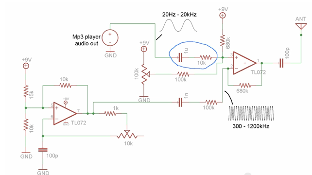

    Hello.
    I am trying to make an AM transmitter for my car so I can listen to my music when I'm driving (I don't have an AUX port).
    I have been successfully able to transmit to an AM radio, but the range is 2 feet AT BEST. How can I increase this range? When I move my antenna further away I get a lot of static and my audio signal becomes inaudible.
    I need maybe around 5 feet to reach my cars antenna from inside my car.
    Right now I am still working on the prototype. I am using a quarter wavelength monopole for my antenna. Are there any compact types of antennas that I can use in this situation? Having a quarter monopole at 1Mhz can get quite long.
    Yes I can always make an FM transmitter to have a smaller antenna but I am short on time and this AM transmitter is practically done.
    Any suggestions? Currently my transmitter operates at about ~8VDC 3mA when broadcasting.

    Sorry, here is the schematic.
    [​IMG]
    One question I have is that isn't the modulation supposed to be done by a dynamic operator such as a transistor? From this tutorial/schematic, the modulation is done by the op amp. Isn't an op amp considered to be a linear device? Or do both suffice?
    I have to agree. What I see is two signals being amplified concurrently by the opamp. The oscilligraph proves this. The output is an audio wave with an RF wave riding on it. An AM modulated wave has bilateral symetry above and below the x axis.
    The audio signal should be controlling the gain of the op amp.
