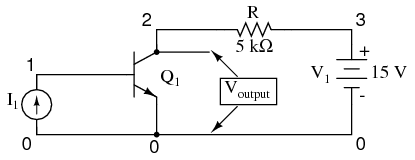

Here is the AAC book chapter on transistors.
Chapter 4: BIPOLAR JUNCTION TRANSISTORS
I suggest you review it, then ask specific questions on parts you don't understand.

You are focused on volts, but BJT transistors are current devices. It is the base emitter current that is important, not the voltage. You have only to meet the basic requirement of 0.6 volts, then it is unimportant.
BJT use a simple formula, Ice=β Ibe
Where:
Ice is Collector Emitter Current
Ibe is Base Emitter Current
β is the gain of the transistor, approximately the same as hfe.
You need to read, then ask.
