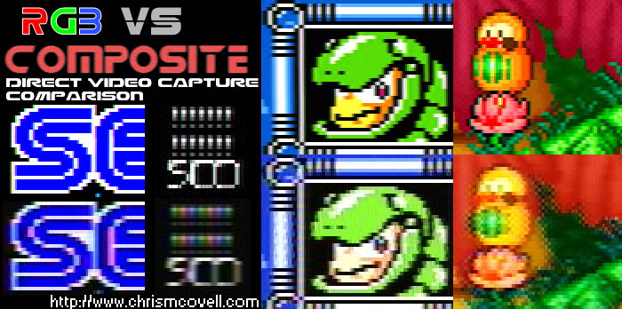

    Somebody might be wondering why all this trouble to use better analog video signal. Here is a good example of RGB vs composite image. Composite effectively loses significant amount of resolution:
