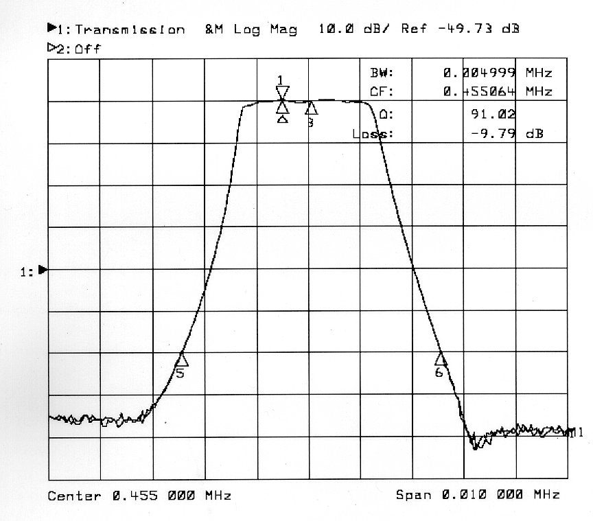

    Note that the first picture is SSB and the second is AM. That is what I mean, that
    I apologize for not being "technical" enough.
    [​IMG]
    [​IMG]
