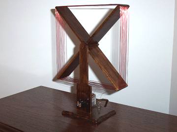

If your original radio AM antenna was this:
It's difficult to make a loop antenna for AM broadcast that is tuned right across the band.
Even something like this:
Usually doesn't tune the antenna across the whole band unless there are also a bunch of taps in the coil that have to be changed at intervals as you sweep the dial across the band.
The AM broadcast band varies greatly in wavelength from one end of the band to the other.
If you have an old AM radio that can be junked you might try pulling the ferrite loop
and tuning capacitor out of that, connecting them in parallel, and connecting each end of that somewhere semi-remotely from the unit, and not resting on any metal surface, across the two terminals that were connected to the first antenna.
That's worth a try if you have a radio to junk.

Well after a year of having other projects to work I'm back at my AM reception issue. The antenna I'm using looks almost identical to the one Art posted above (the store bought one). Last night I used the AM radio in a Walkman as a tester. If I placed the Walkman near where this antenna is at and the static was awful. The antenna is on a shelf directly above a 36" flat screen TV. If I moved the Walkman away from this area the reception became almost static free particularly if a changed the orientation a bit. This area in our kitchen and was under canned light fixtures, etc.
I have a fairly long lead wire on the surround sound antenna and was able to move it a distance similar to where I got the best reception with the Walkman but the reception was never as good. There was always an element of static no matter how I oriented the antenna. Again the antenna looks like the one pictured above.
