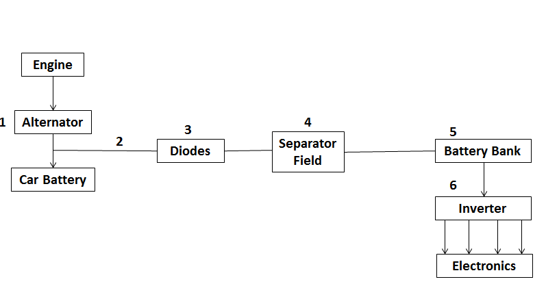

  8. sanforce
    Thread Starter New Member
    Nov 4, 2013
    4
    0
    Here is a new schematic ...
    [​IMG]
    1. Alternator: Might require an upgrade. I'll have to do some research on this. My truck is a 2014 Silverado, I'm not sure what it comes equipped with from the factory.
    2. Wiring: Batteries in parallel. Completed by or under supervision of mechanic/electrician.
    3. Diodes: Something like this? I haven't looked at sizing yet.
    http://www.americanrvcompany.com/Roadmaster-794-Hy-Power-Diodes-Camper-Trailer-RV
    4. Separator Field: Not really sure what this is.
    5. Battery: Marine/RV batteries should be easy enough to find locally.
    6. Inverter: A standard one, but I'll wire it in directly and build a housing for the marine batteries, inverter, and wiring connections.
    http://www.amazon.com/Power-Bright-...UTF8&qid=1383712785&sr=8-11&keywords=inverter
    (external power charge and solar to come later)
  9. Bernard
    AAC Fanatic!
    Aug 7, 2008
    4,231
    414
    With a single diode, houseattery might not charge fully. Might check with RV dealer to see what is now used. I'd go for relay.
  10. tcmtech
    Well-Known Member
    Nov 4, 2013
    2,106
    1,747
    The way I would approach it is to use a dual battery isolator wired directly off the main output stud of the alternator then branching out to the two batteries.
    Reason being vehicles have their alternator's voltage referenced to a point closer to the battery and not from an internal point inside the alternator to compensate for the voltage drops that happen in their wiring harness between the alternator and the battery.
    On the old Delco SI series there where the two input leads usually marked 'F' and 'S' or '1' and '2'. 'S' or '2' was the voltage sensing lead for the regulator and that usually tied into the main wiring harness close to the battery.
    Anyway because of this remote voltage sensing having a .7 volt drop from a battery isolator between the alternator and battery sets won't make much difference being the regulator will just bump the alternators output voltage a bit more to compensate for it.
    Now relating to your stock alternator I would really be tempted to upgrade it to a heavy duty aftermarket one. I am guessing the 2014 Chevys have the typical undersized overrated ones that don't have enough reserve capacity to do anything other than charge their normal stock battery without burning up.
    BTW any good deep cycle marine battery will generally work just fine as a primary vehicle starting battery. Over the years when I have had to put new batteries in my vehicles I usually try and find the largest deep cycle or dual purpose marine battery I can physically fit in the vehicle. Even with our -30 F winters here I have not had any issues with not having enough cranking power from one.
