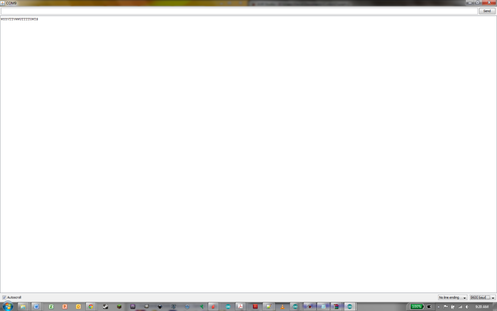

Okay, so I'm trying to transmit my ADC values to my computer using USART using an atmega48. However, when I used my serial monitoring program, I keep getting this output
Here's my code

The serial terminal program will just display the ASCII character that the number corresponds to.
Try Realterm, it can display the actual number instead. It's a little buggy in places but full of features.
Or write a program like mine to display it:

I thought I don't need to since the function argument has an unsigned int .
You thought wrong. It is an integer number that you get from the analog port not BCD.
The easy but less efficient way is to use sprintf with the %d format. assuming your compiler supports it.
The more efficient but more difficult way is to turn it into BCD. Your compiler may or may not have a BCD function.
You could also display as hex characters. I think someone posted such a function in this forum not too long ago.
Also remember you are displaying some number that is just a representation of voltage. You are going to have to calculate the actual voltage based on the number of bits your analog input supports and the values in your voltage divider.
