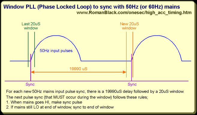

    Hi I am working on a project analyzing the ac power line and I need to detect the zero-crossing point using an 16bit ADC, is there a smarter/better way of doing this than
    if(last_sample==<== adc_average&==&== current_ sample> adc_average)
    I sample 128 times per period and I'm calculating the adc_average every period, by using the method above I'm still having some jitter when detecting the zero-crossing.

  8. THE_RB
    AAC Fanatic!
    Feb 11, 2008
    5,435
    1,305
    Hi Eric, I believe he is sampling 128 times during each mains cycle period?
    For the O.P, I think you can use a "debouncing" system to remove any noise artifacts near the zero cross point.
    You can use similar code but detect when the ADC has been >avg for X samples (detects / edge), then when it has been <avg for X samples you detected the \ edge.
    A more sophisticated system uses a window, and will be safe even when any individual zero-cross is damaged;
    [​IMG]
    The one above I have used many times with excellent result. Because it syncs first, then only tests for the edge during a tiny window, it will negate large errors that occur during any one cycle and give a solid sync even if there is some nasty noise at times.
    More mains sync systems are shown on this page (3/4 down the page);
    http://romanblack.com/onesec/High_Acc_Timing.htm#decfreq
