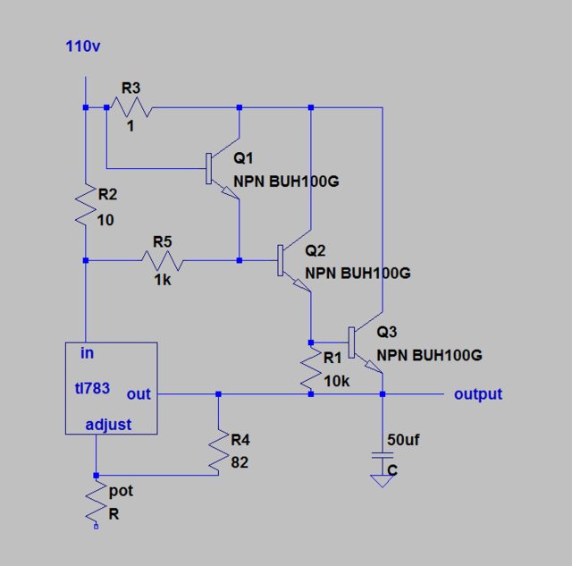

    I'm looking to make a cc-cv power supply. A very simple one at that! Basically I just want an easy way to get 80v-100v. The tl783 is a linear regulator and can handle that. The data sheet even shows how to use it with some power transistors for higher power. The following is something I made in ltspice, and is copied directly from the datasheet.
    [​IMG]
    I'm looking for reliability at 2a-3a of power. Hopefully it won't be a huge package either. Can anyone advise me on my drawing if it looks good? thanks!

    Q1 and Q2 must be PNP transistors, not NPN.
    With 110V in, 80v out, and a 3A load, Q2 will dissipate 2.7 Watts, the regulator ~9.2 Watts, and Q3 about 70 Watts.
    Do you have a plan for getting rid of all that heat? You'll need a big heat sink for Q3, and even then it'll be hard to keep it from melting.
    Datasheet for the BUH100:
    http://www.onsemi.com/pub_link/Collateral/BUH100-D.PDF
    THermal resistance junction to case is 1.25°/Watt, so that's 87.5 degrees above the temperature of the heat sink.
    If the temperature of the case can be maintained at 25°C, then the maximum power dissipation of the transistor is 100W; but you derate 0.8W/°C above 25°C
    When you are using linear regulation, the only way to reduce the voltage is by burning off the excess power as waste heat. If you live in a cold location, that's not all bad.

    Thanks for the thought out reply. I'm coming to terms with this, despite spending a fair bit of time on this project. It was fun, but I'm afraid you're right.
    [​IMG]
    Here is a current limited, voltage adjustable power supply I made in LTspice. It seems to work.
    However, I understand that even if I take care of the heat problem, I would still need a massive transformer. And since this is supposed to be a mobile power supply, I'm not sure I an handle that. And large transformers are expensive as hell. I don't know what to do next to buying a commercial SMPS unit from china of unknown quality :(

    That schematic in post #3 is a disaster waiting to happen. 2N3055 transistors can not be trusted to share the load like that. You need most of an ohm in each emitter circuit to make them behave properly because their Vbe will not match and the best transistor will go into thermal runaway as it heats up and becomes even more conductive.

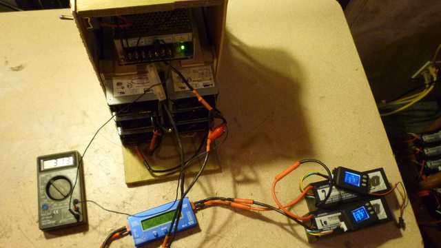

    I thought ya'll might like to see my @ home charger
    [​IMG]
    I got 6 12v50a server power supplies for $5 each shipped. On the top I'm using a meanwell switching supply to limit current and fine tune the output. Here is the build thread.
    Others use the variable lab supplies mention to for voltage and current control. This setup is overkill for my 800Wh pack, but I wanted something that'd be easy to scale up for whatever EV project I build.
    Anyways, I was quite happy with the performance I was getting at 20s. I wanted wheelies, and only kinda got them :D so I'm going to be running 22s now which should have a final charge voltage of 22s * 4.15v = 91v. Still not sure how I'm going to achieve this. Too busy with school right now to do anything complicated :/
