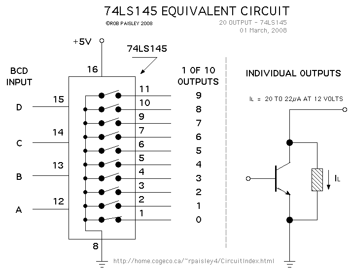

bertus
Joined Apr 5, 2008
22,270
Hello,
The drawing with the 74145's is correct.
The outputs are open collector outputs.
The outputs may be connected.
See the picture on the site :
Greetings,
Bertus
SgtWookie
Joined Jul 17, 2007
22,230
The 4017 would only work if you had open-collector transistors (or open-drain MOSFETs) on each output. You can't simply wire the outputs together as you can with the 74x145; as the latter DOES have open-collector outputs.
You could use a ULN2803 or ULN2804 (depending upon your logic voltage) as a driver IC; both contain eight Darlington pairs; the main difference between them is the input base resistance. The 2804 is for 6-15v CMOS logic.
