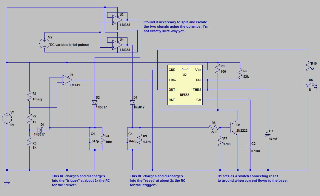

I've been working on this for a few weeks and I got this to actually work in this scenario:
1) Trigger the piezo
2) LED goes on the time Period, t = 1.1 RC.
3) Trigger the piezo again within the time period, t=1.1 RC
4) The LED goes off quickly and back on for the timer period, t = 1.1 RC.
I left out the piezo trigger in this image to simplify...
It works, but does this look ok? I was sort of wondering why I had to "decouple" the split signal with the op amps (this was something I picked up watching this http://www.youtube.com/watch?v=ZmYMKASTSO8 at about 14:00 into the vid).

Eww . . op-amps. Analog black magic. Sorry, you are now talking well outside my level. :rolleyes: But hey, if it works, it works.
I liked Tubeguy's suggestion, but in my limited understanding, I was afraid the LED would have to lag all the time behind the 555 output very time the output went high which includes the first time the trigger is tripped. I also wasn't sure how to account for multiple rapid triggers, the fear being the RC circuit may not have enough time to charge/discharge between rapid triggers.
As an alternative, I think I may have a solution using two 555's, shown below.
Most importantly, look at the timing diagram and let us know if this is what you are trying to accomplish. The hardest hurdle for me has been "seeing" what it is you want to do.
R1 and C1 work as an edge-trigger preventing the output from staying on indefinitely in the event the trigger signal stays low.
When a trigger signal is sent, U1 output goes high and the LED comes on. During this time, the reset pin to U2 is tied to the output of U1 and is now enabled but still off.
If a trigger signal is sent while the output from U1 is still high, the timing for U1 is reset thanks to Q1. Because U2 is enabled, this second trigger signal trips U2 and its output goes high, turning off the LED through the PNP transistor Q3.
If a third trigger signal is sent while U2 is high, U2 timing is reset thanks to Q2 and the LED is off for longer. If this is not desired, Q2 and R4 can be removed.
I have not tested this, but I think it will work . . . :D
