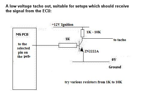

    Hi all,
    I'm new to this forum and would like some help related to a new computer i just installed in my car. The tachometer doesnt work because it requires a 30 volt square wave signal but the tacho signal from the computer only provides a 5 volt square wave signal. Apparently i can use a 2n2222a for this, I have tried these circuits but with no success:
    [​IMG]
    [​IMG]
    Any help would be greatly appreciated!
    Thanks :)

    That 30 volt requirement sounds steep for a car. The tach may want a signal off the electronic ignition. The circuits you have posted will only switch between 0 and 12 volts.
    You might find a DC to DC converter that will pump your 12 volts up to 30. Just use that in place of the 12 volt source on the first circuit. Use a 3000 ohm resistor in the collector-to-source position to keep the current down.

  5. nomurphy
    AAC Fanatic!
    Aug 8, 2005
    567
    12
    As previously mentioned, you will need a DC-DC converter to create a 30V supply from the 12V battery, Maxim is a good source for a boost converter.
    The 30V supply would then substitute for the "+12V Ignition" in your given schematics.

    Looks like this is just what you need:
    http://www.maxim-ic.com/quick_view2.cfm/qv_pk/3138
    [​IMG]
    But you'll need to use an input regulator to step down the vehicle's battery voltage to 11v or less. LM317 Vreg or a 78xx series fixed Vreg, where the "xx" is 05, 06, 07, 08, 09, or 10. 78xx series regulators have various prefixes depending on the manufacturer, like AN, LM, uA.
    Since the regulator is going to be a ways away from the battery, don't forget to use decoupling capacitors on the input and output of the regulator to prevent oscillations.
