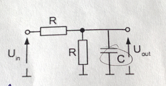

Hello everyone, I'm doing my homework for tomorrow and there are only 3 questions that I couldn't solve. I'd be grateful if you help me to solve and understand this questions.
1-) Calculate the spectral transmittance of the circuit below; calculate output voltage Vout while R=1K ohm, C=1 microfarad and Vin=2sin(wt+Pi/2), w=1000 rad/s.

What do you calculate the Vin to be using, 2sin(wt - pi/2) ,, where w =1000 rads.??
E
EDIT:
The two R resistors attenuate all frequencies from 0Hz and higher by 6dB.
You have to calculate the frequency at which the Vout is 0.707 of its initial value.
Xc = 1/(2 *pi* F * C) which is in parallel with the resistor value.

I'm really grateful for your answers sir. I couldn't do the last one, maybe I'm too tired, I couldn't understand it.
