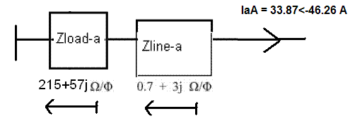

I need help working this one out. Would really appreciate the help.
A 3-phase, Δ-connected source has an internal impedance of 0.9 + 9j Ω/phase. The terminal voltage is equal to 13,200 Volts when no load is connected. The generator feeds a Δ-connected load with a per-phase impedance of 645 + 171j Ω/phase. The impedance of the transmission line connecting the generator to the load is 0.7 + 3j Ω/phase. The a-phase
internal voltage of the generator has been specified as the reference.
a) Construct a single phase equivalent circuit of the 3-phase system
b) Calculate the line currents: laA, IbB, and IcC
c) Calculate the magnitude of the line voltages at the terminals of the load
d) Calculate the magnitude of the line voltages at the terminals of the source
e) Calculate the magnitude of the phase current in the load

The first challenge is to convert the delta connected source & it's associated source impedance to a wye equivalent.
Can you do this?

Looks like you left out the equivalent source impedances for the star (wye) transformation. Apart from that it looks OK.

That's pretty good. Why have you got the 30 degree phase lag on the source impedance - it's not relevant. The source impedance is just 0.3+j3 Ω.

So for part b:
Z total = 216 + 63j
= 225 < 16.26 Ω
IaA = 7621<-30 / 225 < 16.26
=33.87<-46.26 A
Therefore:
IbB= 33.87<-166.26 A
IcC= 33.87<73.74 A

c: line voltages at the terminals of the load
Ztotal=215+57j+0.7+3j
=215.7+60j
=223.89<15.54
Van=(223.89<15.54)(33.87<-46.26)
=7583.15<-30.72
Vab=13135.42<-0.72V
Vbc=13135.42<-120.72V
Vca=13135.42<-240.72V
I hope both sides were supposed to have the same line voltages.
How do you 'calculate the magnitude of the phase current in the load' for part e?
The load terminal-to-neutral voltage on a given phase must simply be the phase line current times the equivalent phase line-to-neutral load. You would not include the line impedance - which you did.
So
Ia_line=33.87<-42.26°
Z_load_a=215+57j
Hence V_load_a (line-to-neutral) =33.87<-42.26°*(215+57j)=7533.62<-27.41°
From which you can find the line-to-line value....etc
The load phase currents are (presumably) the values of current flow in the load delta arms based on the previously calculated line currents. Essentially a star-to-delta transformation of the line currents.

Would that make the line voltages at the terminals of the load:
Vab=13048<2.59v, Vbc=13048<-117.4v, Vca=13048<-237.41v
And for the phase current:
I=33.87*sqrt(3)
I=58.66A
I=33.87*sqrt(3)
I=58.66A
Voltages look OK w.r.t magnitude - I haven't carefully checked your phase angles throughout your solution. I have Vab at the load leading the phase-neutral supply (your Va'n) by 28.59° whereas you have the corresponding phase lead as 32.59°. So we have a discrepancy there - looks like a simple algebraic sign issue. I'll re-check my overall solution when I have some time.
The phase current (in the delta arms) magnitude would be 33.87/sqrt(3)=19.55A.
