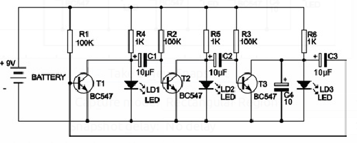

    I would like to make a circuit, (without using any ICs), that chases 3 lights, (1 channel on at a time). I have tried expanding a 2-channel astable multivibrator circuit to 3 channels, but 2 lights are on at once instead of just one.
    So, how should I go about making such a 3-channel light chaser? It might be more complex than I think.

    Is this what you were trying to do?

    Oh, yeah! That works great. I'll be lighting some 6v incandescent lights though, (2 with 18 ohm loads, and 1 with a 15 ohm load), so I'd have to use a higher voltage, Maybe 12v and divide the voltage with corresponding 18 ohm and 15 ohm resistors instead of the 1K resistors. I do have some 1A rated transistors that would work for this. I wonder if there is a way for me to pull less current through the transistor, 600mA is a lot to pull just to turn a light off.

    I just need to ditch the 100K resistor, don't I? Then it should do 1 light at a time. I'll use a diode to drain the capacitor to ground also.

    I did find this circuit the other day, and I built it, but it didn't work very well. I used 25 ohm resistors for the load resistance.

    If you use PNP just make sure the Emitters go to the positive supply just as NPN go to negative supply.

    Well, I tried my simulator with those values in the Xmas light schematic, but I built my circuit using a 470 ohm load with LEDs, and a 9v battery; all other values are the same. The effect is confusing; sometimes I can trigger a very slow chase by charging one of the capacitors before running it. But I always read about a 140ns wave period on my oscilloscope between the capacitor and the 100 ohm resistor. I tried changing the capacitors from 220uF to 22uF, and nothing changed.

    Hmm, it looks like the 140ns wave is coming from the diodes.
    Well, Dodgydave, it looks like I will be using a 555 timer or something similar, I just thought this circuit could be simply done with a few transistors and capacitors.

    Ha ha ha! So the noob strikes again! All I had to do was use the astable multivibrator model as a reference to trigger my load: The noob strikes again.jpg
