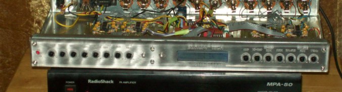

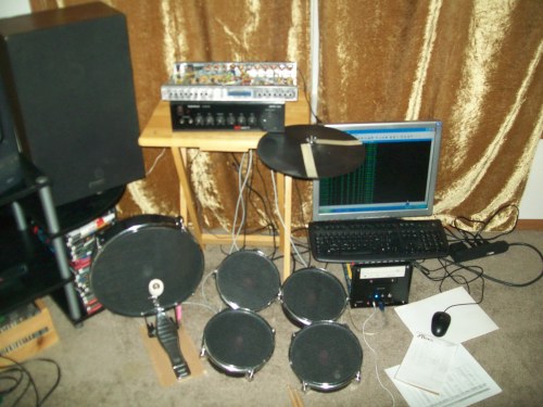

Just thought I would share my latest electronic project,
.... Although I only copied someone elses design to make this one (freely available @ www.edrum.com, thanks to Admir Salahovic) , I still put a lot of work into making the analog interface PCB's and the the rest of the PCB's required by the project....
I literally fabricated all the parts to this project so it not only involves electronics but metal working, milling Lexan, some wood working, etc....
And I managed to put this project together at a very low cost by reusing some components salvaged from other electronics....

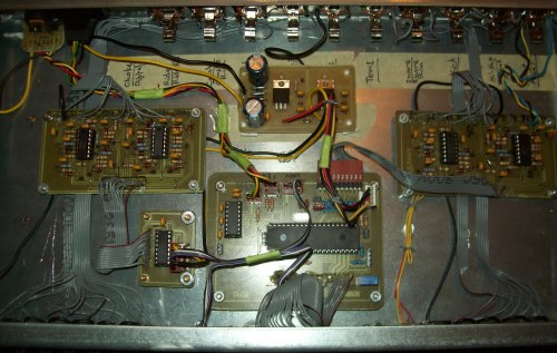

The project is based around a PIC16F877A uc and some LM324 Opamps providing 15 channels of analog inputs to interface to 15 different piezo sensors used as the drums and cymbals trigger inputs....
I am still currently finishing a few parts for the project (such as the top cover for the module housing and the drum rack, and also the cymbals, trying to find some "quiet' material to use for them).
Everything is done in a DIY low cost fashion and it still rivals some expensive edrum setups available in the market today.....
Stop by and check it out if you like @ http://www.morse-code.com/id208.htm let me know what you think of what I have done so far.......
